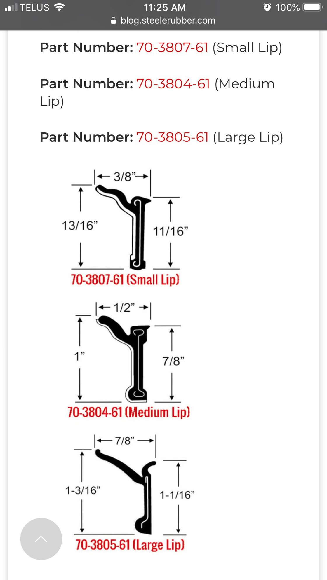

These are the profiles of Steele Rubber Products universal if outer belt line mouldings. Mine need replacing on my ‘92. I haven’t taken the old ones off yet.
Anybody want to guess which size would be the best fit?
I’ll deal with the flange cover after I’ve got everything apart. Hoping for inspiration is the best I can come up with as far as that goes.

None of those Steel Rubber beltlines look right.This picture might help you https://catalog.prp.com/images/Websi...0_87_LGE-1.jpg That looks like the driver side.
I got mine from these guys https://www.prp.com/ I have a write up about the project on this site. https://dodgeforum.com/forum/1st-gen...ndow-trim.html
They no longer make them because their equipment got damaged. i have emailed with them and if there is enough demand they will look into repairing the moulds and doing a new run. I also did the glass run channels with them as well. They do have the inner beltlines still. I just replaced my interior panels with new ones off RA which had the inner beltline attached.

I’ve checked with Precision Rubber. That’s where I got the rest of the rubber for the doors. I’ve also checked other retailers hoping they have old stock. No luck. As near as I can tell there aren’t any left anywhere.
I’m hoping that someone has discovered another profile that fits close enough.
I had read somewhere else that the outer belt line mouldings from the rear doors on the Mega Cab fit but I can’t find the post again.
Here is the link to the Mega Cab outer beltline mouldings.
https://www.prp.com/product/detail/353715?SearchType=AGR&sort=u.Name&paginationCount= 24&year=2008&make=Dodge&model=Ram%202500&type=All
It’d be useful if catalogues had a cross section of the different profiles so we could compare. That would be helpful in finding a “good enough” profile.

There is no picture at that link for me. I looked it up and it sort of seems like the outer visible part might work. But if you look at the picture I linked in my last reply all that stuff below the strip you can see hooks over the door edge and screws into slots for it inside the door. If you look through my thread the window has to be dropped. I think there was 5 screws spaced evenly. The beltline itself is stiff with no flex to it.
Here is the part number from the parts manual in the FAQ
outer belt moulding 4260 134-5
Just found this https://aftermarket.supply/chrysler/4260134.html
