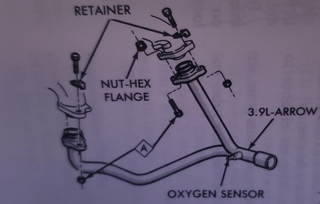

Anyways, I got under there and took a look at the exhaust some more. It for sure is a pull thru from the top setup. Meaning the Manifold is machined to except a bolt head and the Stud would "hang" there and accept a nut at a minimum.
I wish I had a parts diagram of the manifold/flange area as that would for sure tell me if this was standard.
Unfortunately the nut and bolt combination around the flange is rusted/decomposed decently and as the bolt falls in the manifold machined recess area its about impossible to get a decent grip on the end of the bolt so it spins.

Default Confirmed...Exhaust...
All,
FWIW...I confirmed that this exhaust manifold is a stock setup please see the below image I found in the 1988 Dodge Dakota factory Service Manual.
Clearly a nut and bolt combination without springs nor a Exhaust Donut.
