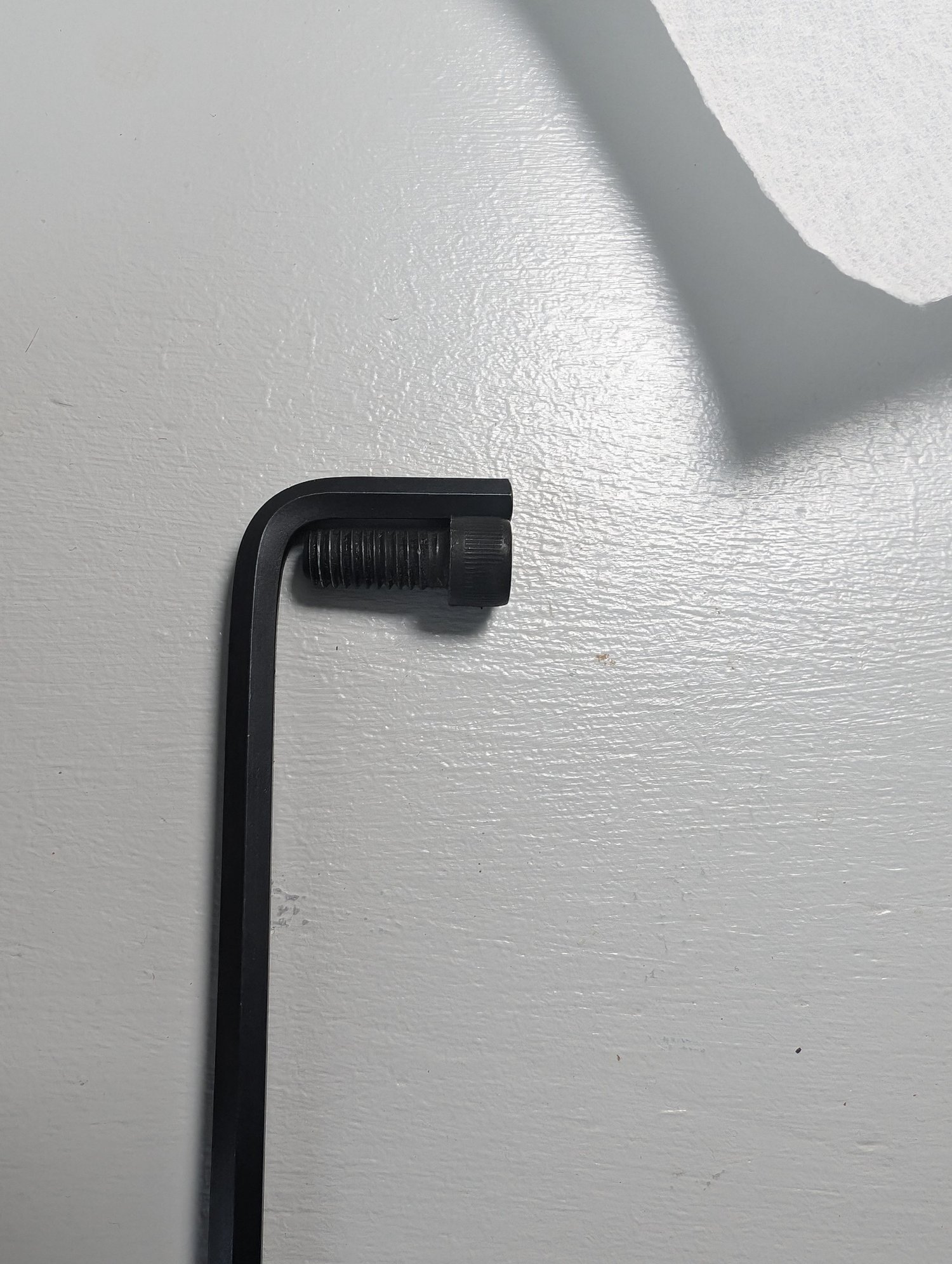

Notes on having the bolt out
It's a 1/4 in drive not a 6mm. And the thread is identical. I tried these at AutoZone still kind of hot and couldn't get a proper line up on the hole. Cold it was a perfect fit aside from being too long
If you're confident it is the correct thread and you wont booger them up (that would make for an ugly problem) then just slap some washers on the bolt. It wont need to go as deep into the threaded hole.
