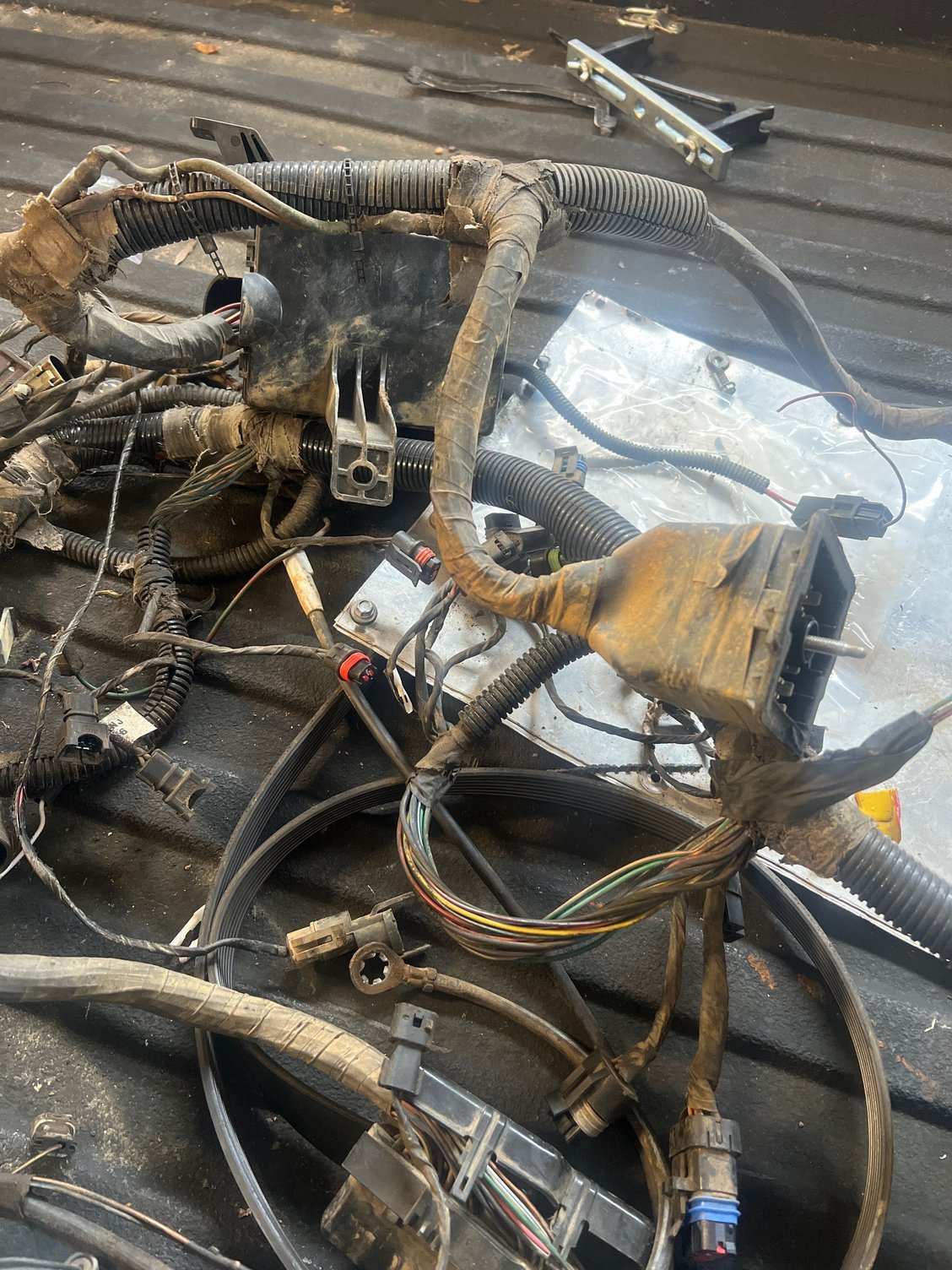

Welp am now in my next setback. Something I guess I overlooked, the 92 computer runs almost everything on the truck, lights, accessories, engine, etc. The new harness and computer I have is setup for what I’m assuming is a truck that has a BCM as well, along with the fact that the firewall connector doesn’t exist on the new harness.

What year harness?
There is a bit more to the wiring for the OBDII stuff, but, all the accessories should still work the same way. That didn't really change until 98.

What year harness?
The ECM is from a 96 1500 5.9, the harness is from a 97 1500 5.2, though I feel like I should’ve gone with a 96 Dakota 5.2 harness now that I think about it.

That *should* work. Have a look at the wiring diagrams, and see what the wires on the extra plug are supposed to be doing.

I’ve got the big firewall connector and the fuse box, I haven’t yet taken apart the box to see if there’s a connector in there, but there definitely is not a firewall connection on the new harness. I’m assuming I can just Jerry rig it for the time being and then get a 5.2 1996 Dakota harness if that would be a better fit?

Probably run into the same issue. Things changed with the advent of OBDII... not idea how much on the Daks.
