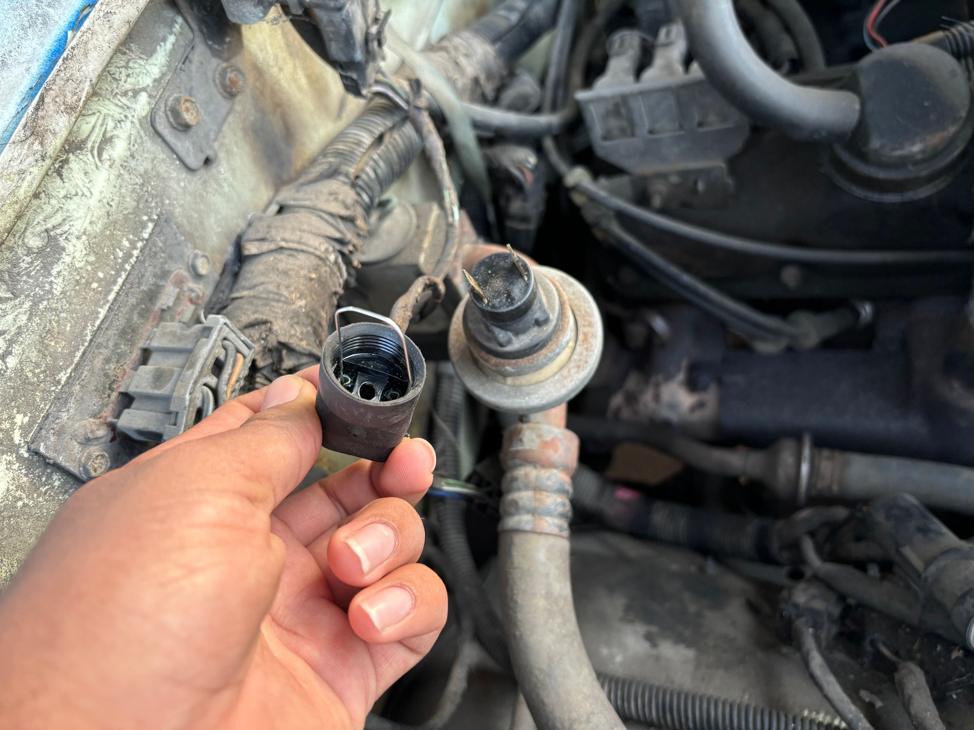

Hey guys I have a 1988 Dakota 3.9 v6. I bought it in may this year. The AC compressor doesn’t kick in when I press the ac switch. So I read a forum and some guy said that it might be low on Freon. He said to take a paper clip and put it in the (idk remember what it’s called but I did upload the pic). AC compressor kicked in after I did the paper clip thing. So am I doing the right thing? Also can someone please help me with this freon issue too. How to do a retrofit.

What refrigerant is your system currently using? (should be a label on the radiator support....)
If that is the low pressure switch, then the system is simply low on refrigerant. The question becomes, HOW low, and WHY is it low. Generally, that implies a leak in the system somewhere.

System needs to be completely evacuated, pressure switches changed, then recharged with the appropriate amount of R134a... or whatever it is they are using these days. Somewhere in there it needs to be leak-checked as well. Be a lot easier to take it to a shop.....
