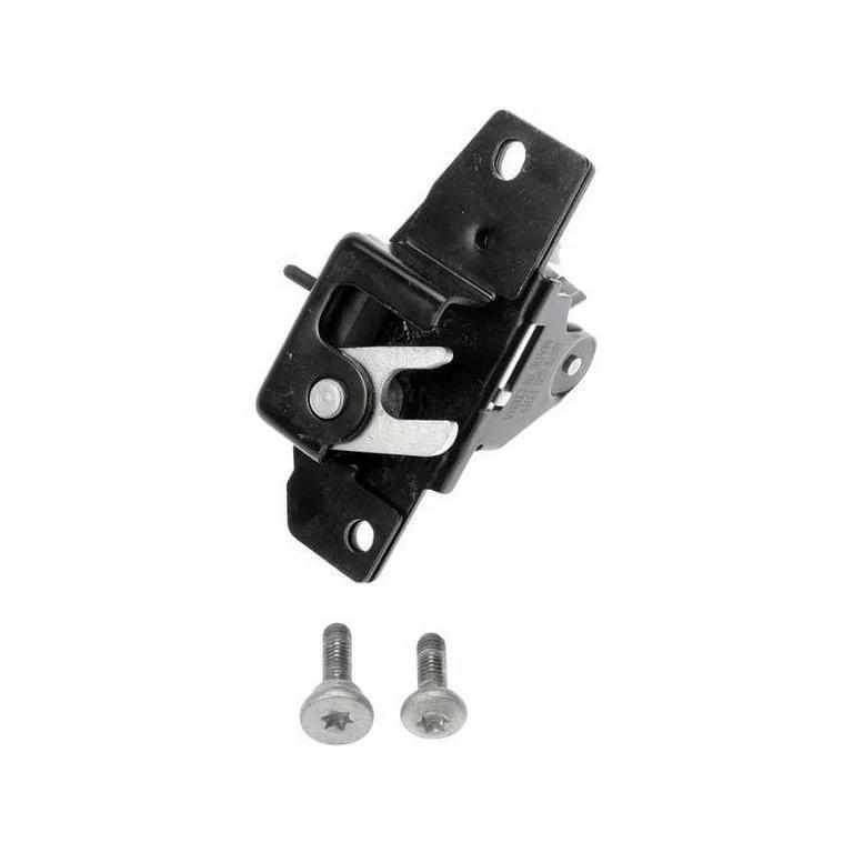

Here is a image of a replacement for a 87-2010 Dakota.
From inside the tailgate is the only way I see it coming open .... perhaps using the existing rod assuming it is not broke. Is a small hole to fish in.

I think trying to find that hole blind is going to be challenging, to put it mildly. Looking at the lever though, should be able to just hook it, and give it a yank.....
Another option would be to drill a hole in the right spot, stick a screwdriver through it, and trip it that way.
