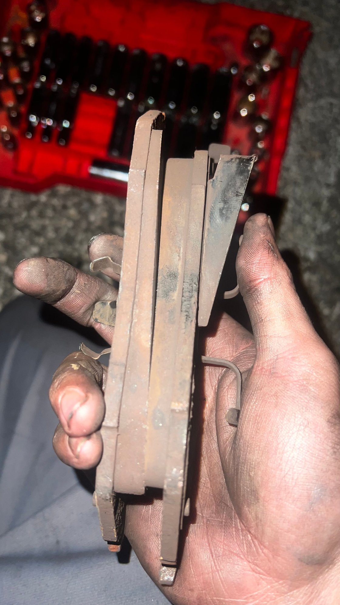

my current pads had a very strange wear pattern, almost like it was actually caused by them being diagonal on the rotor.
see below:

First off, you need to go see your Doctor. I'm serious. See if he can schedule surgery to remove that lead from your right foot! That wear pattern is stopping hard from speed. I've had the same issue, that's why I mentioned the lead foot. Your calipers are designed to float. When you stop hard, they twist a bit. I've actually had them rubbing the inside of the wheel. The pads will tighten as soon as you step on the brake. You might grease the pins the calipers float on with a little synthetic caliper grease. Not much, just enough to slick them up.
I actually recall the rotors feeling warped basically the entire time I’ve owned the truck (2 years now), I just never actually looked at the pads. The rotors were warped which is kind of what I thought caused the pad wear, though I’ve never seen it that off.
