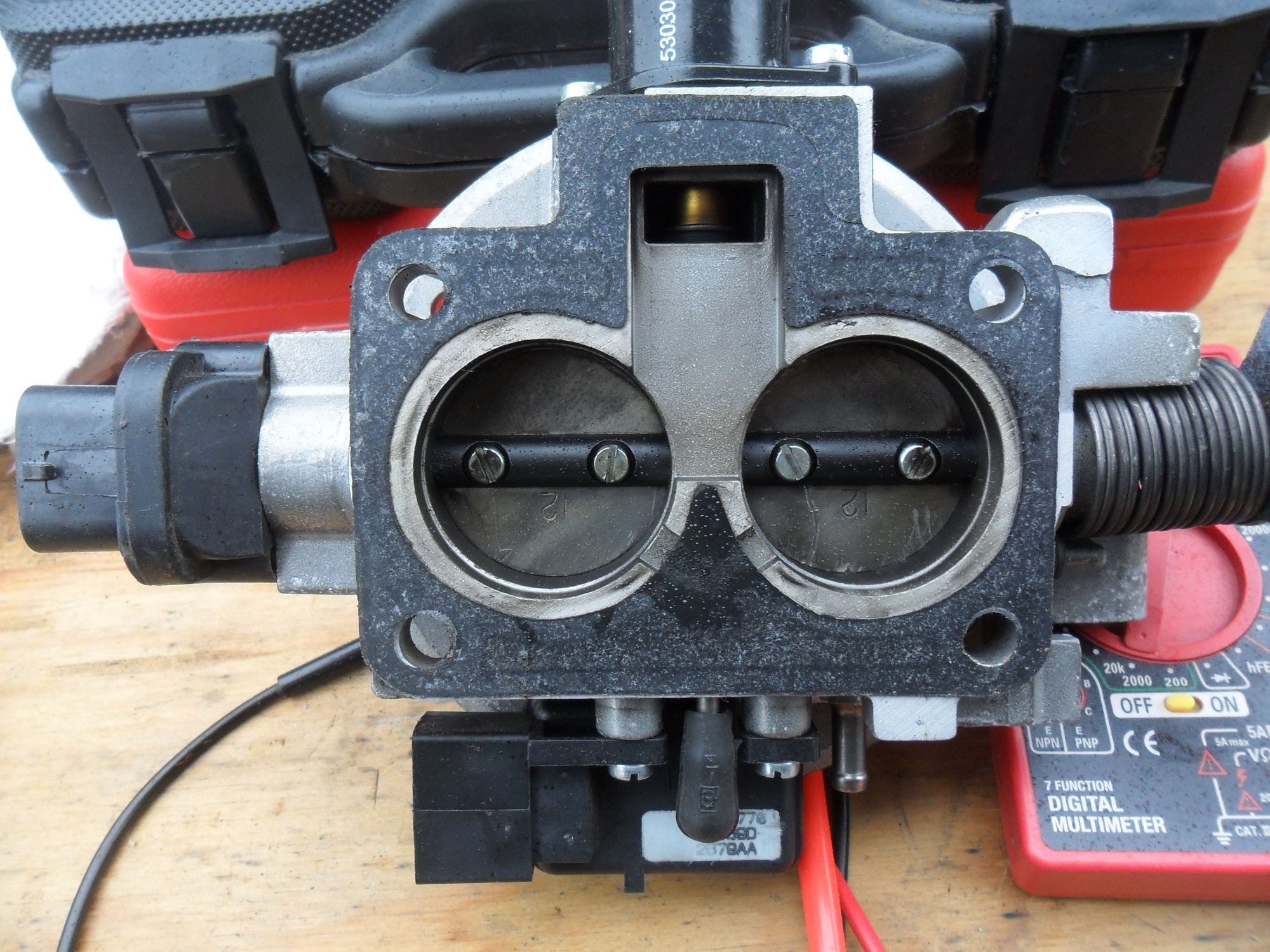

I tested the coil with it in the vice same result. Not sure if it is making contact with the probes or if it is in fact defective. Removed the TB and the sensors on it. Cleaned them and put it back together. Needle nose locking pliers help with the getting throttle cable back on. Pull it all the way out of the housing then lock them on the cable lightly next to the housing. Rotate the throttle mechanism to fully open and hold. Put the **** in the slot and then set the rest of the cable in its groove.
Fuel pressure went down to 32 in 35 minutes and after an hour 20 was at 31. So I'm calling that good and took it off.
Picture of the TB before cleaning. It is new about ten years first time off since installed. Th Odo is at 173. Oh yea I also changed the oil and filter when I did the plugs wires cap rotor and coil.

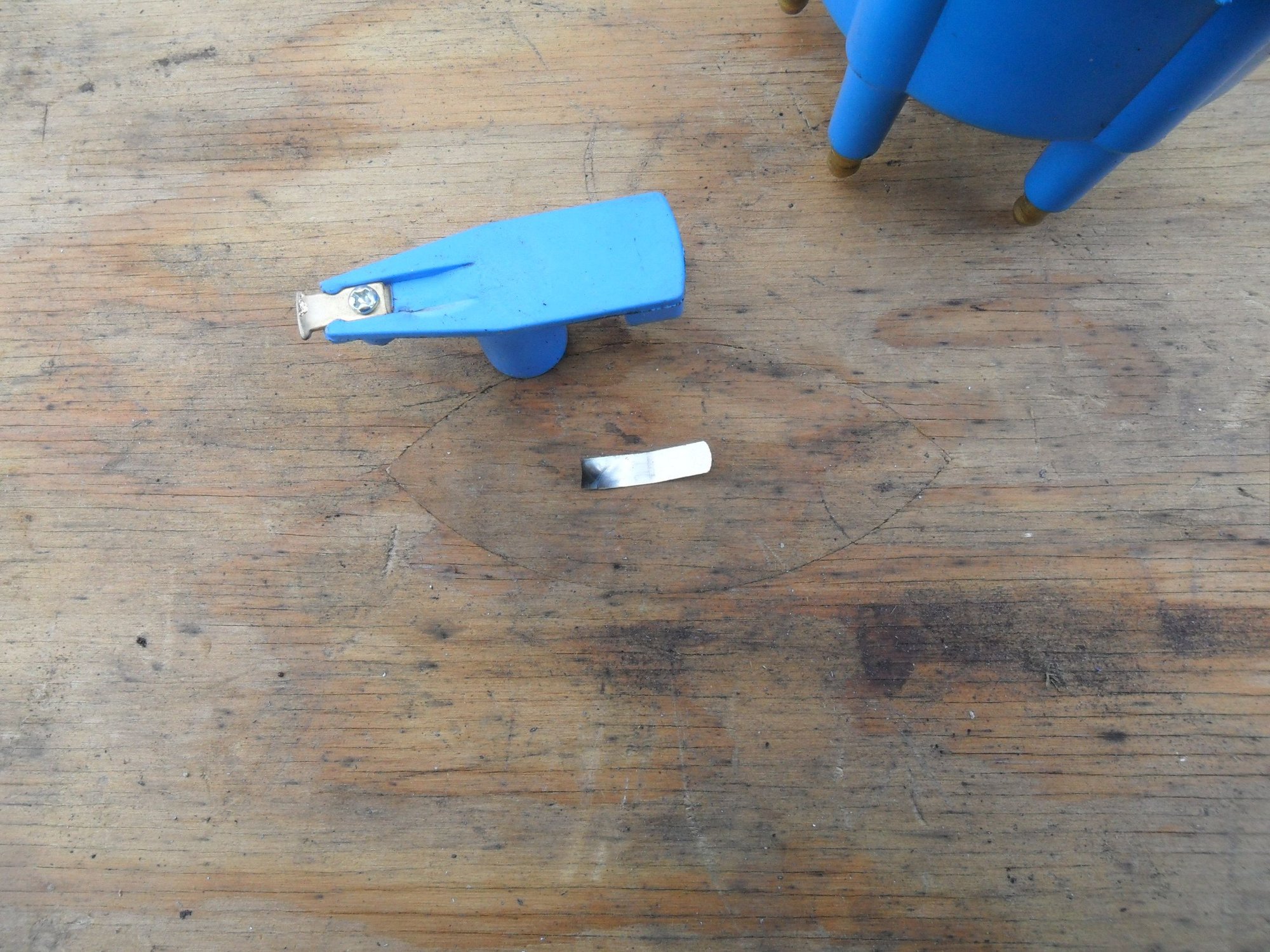

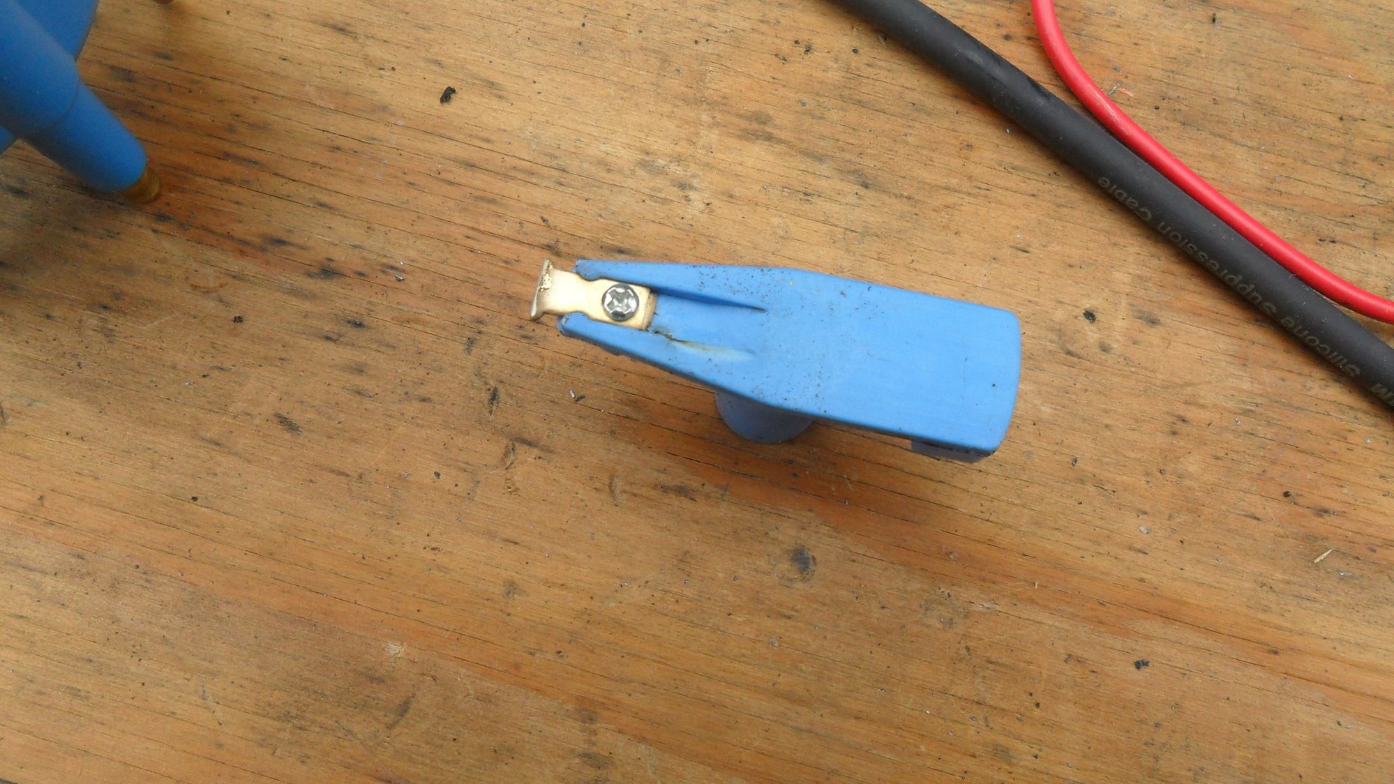

Edit added pics- . IDK how the rotor works w/o the metal extending to the center. The center of the cap looks like it arced. The cap rotor wires and plugs are new in the last couple months.

I decided to go get a cap rotor and coil. Only got the cap and rotor. There is a story there. I will not be using Napa around here any longer. I would like to claim I knew the tang was broken beforehand but I didn't, until I looked at the one in the store. I know every other rotor I ever installed had one but I never paid attention when I installed it so??? The guy joked it was Bluetooth.
Got home put it together with the coil I have and it runs right.
Lesson- Always check the last thing you did, before doing something costly.
The tang from the rotor was sitting on the pickup coil when I looked for it.

WOW the tab on the rotor broke! When you put the cap on make sure nothing gets under it. If so it will offset the cap. Also stay away from aluminum inserts like this one. Ask for "oem stye" at the parts store. They should give you one with brass inserts(last a lot longer).
