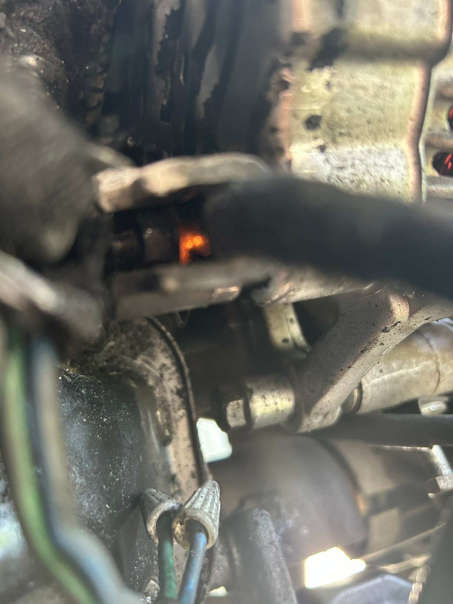

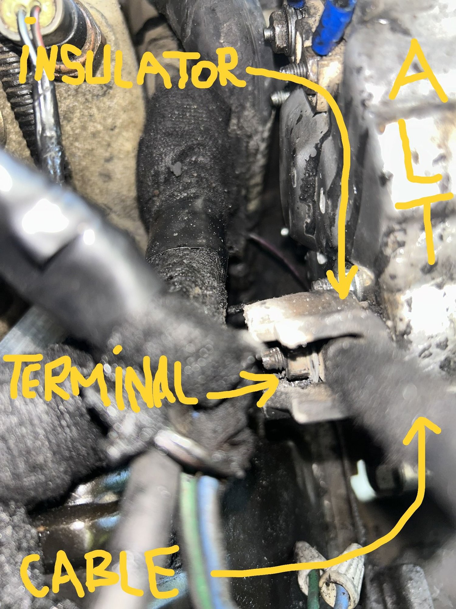

Well, I think I'll just post a couple of pix instead. I think I found a possible source of the fire. See pics below. I looked down the insulator on the back of the alternator where the cable (alt to PDC) stud mounts to the alternator and I see it is sparking about that stud/bolt well inside the insulator. Not continuous sparking but close to it. At least I know now why they have an insulator around that connection. Is this normal? I couldn't possibly tell you how long this sparking has been going on. Forever? Recently? No idea.

Looks kinda crusty..... I would be tempted to pull it, clean it up good, inspect the wire, and the crimp for the connector VERY closely, and if all looks good, put it back together. See if it quits sparking. (it really shouldn't be doing that.....)
