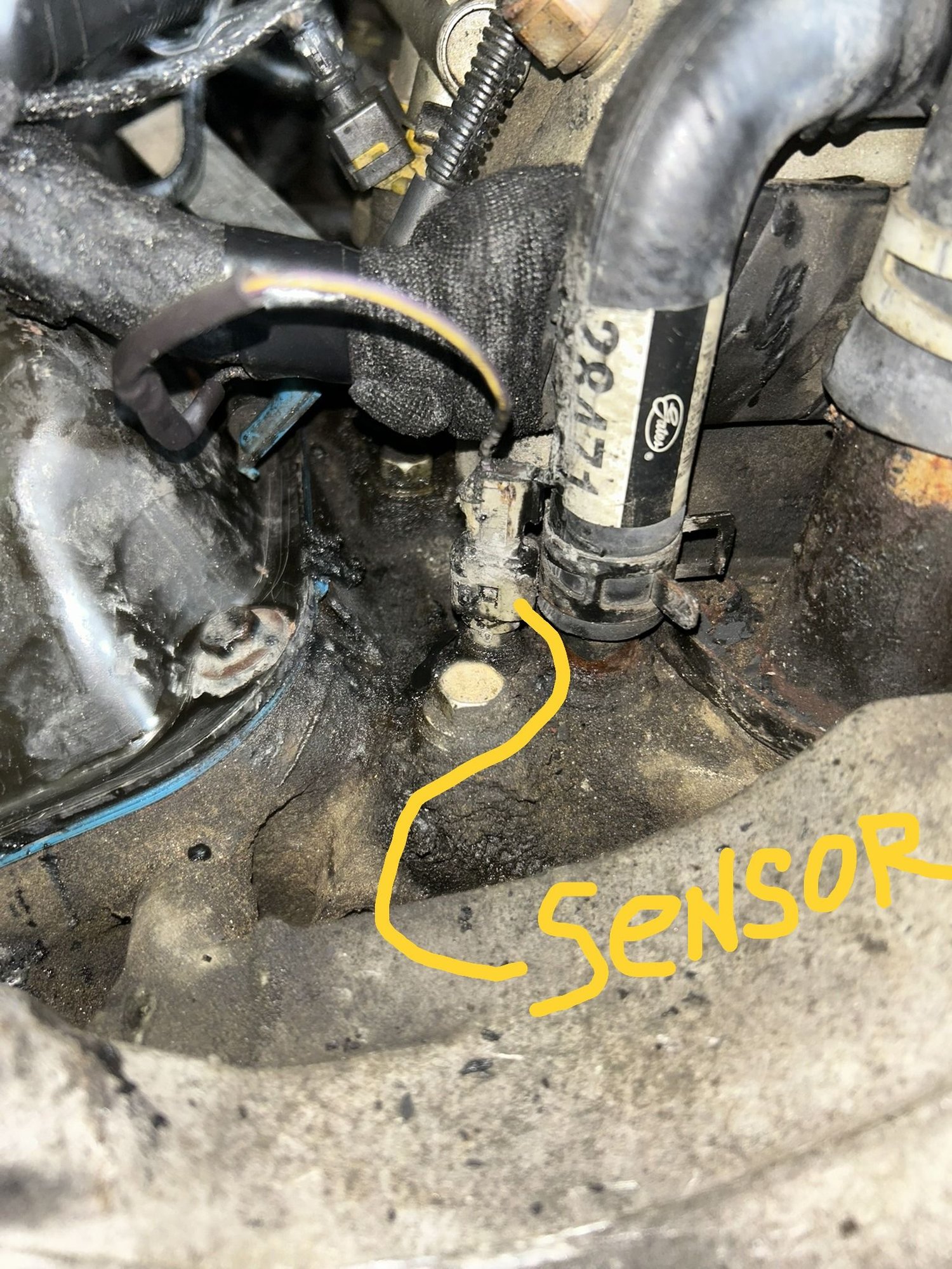

I'm curious...which sensor is this? I'm guess it's a temp sensor for the coolant?? It had fire damage as well. About 1.5" was missing insulation. Got it repaired. Seems to be working. At least I haven't noticed anything out of the ordinary.

can't tell from the pic really, but, if that's a one-wire sensor, it's for the temp gauge in the dash. If it is two-wire, that's temp sensor for the PCM.
