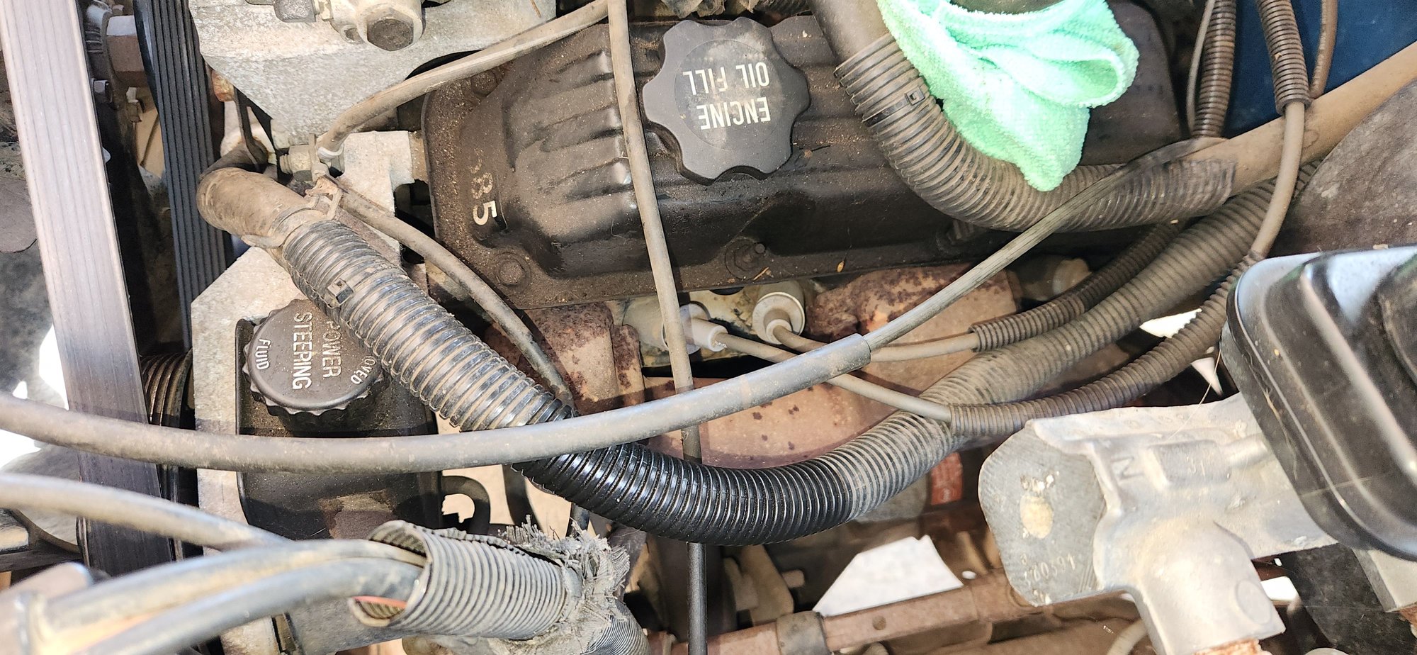

As the Title says I have a 1993 Dodge Dakota 3.9L v6 with a manual transmission. Just bought the car a few days ago and have had a few problems.
The truck has run great so far except this started happening yesterday immediately after putting fuel into in it. Check the video linked below:

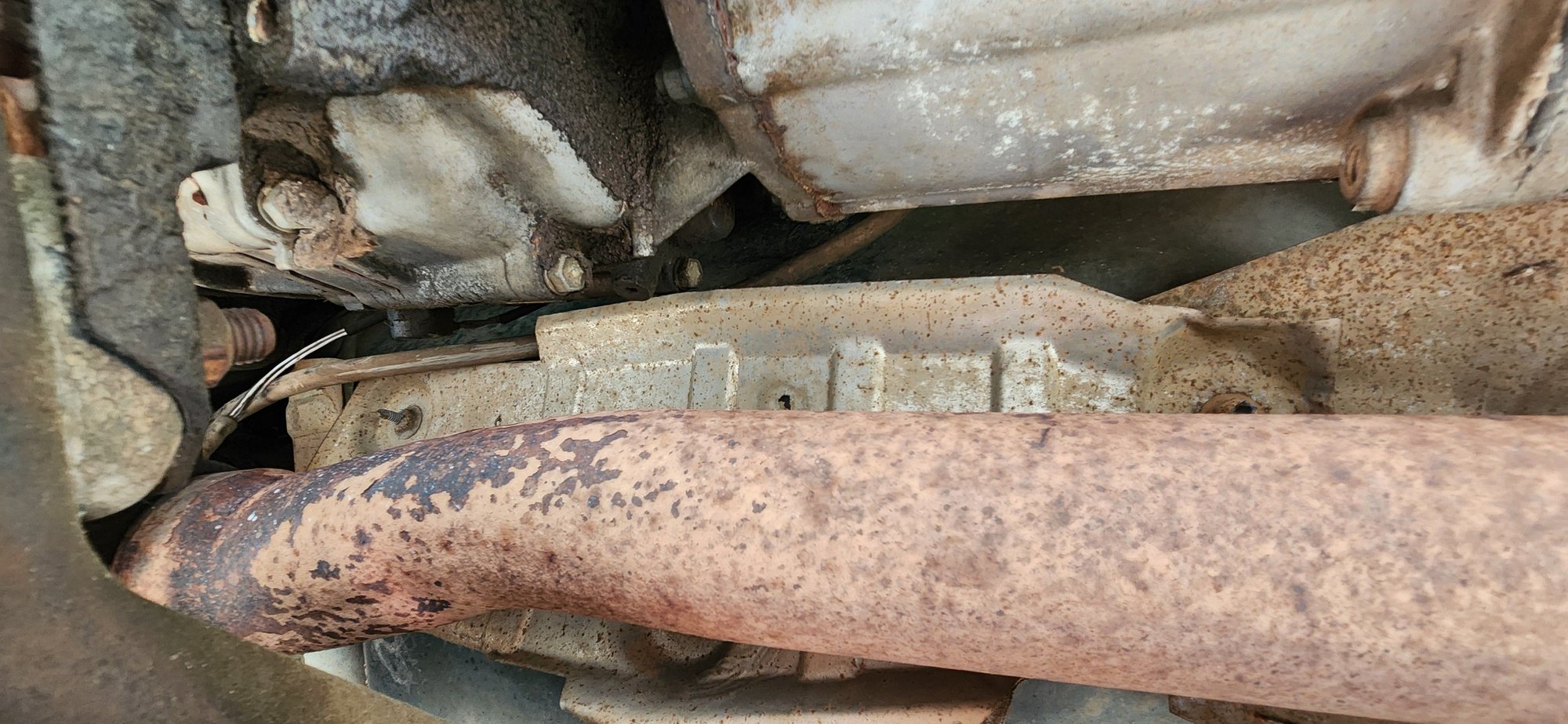

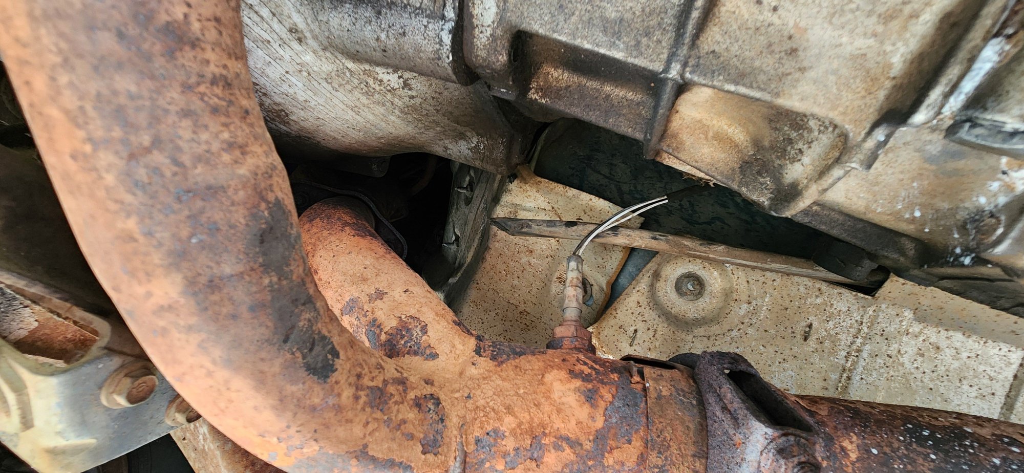

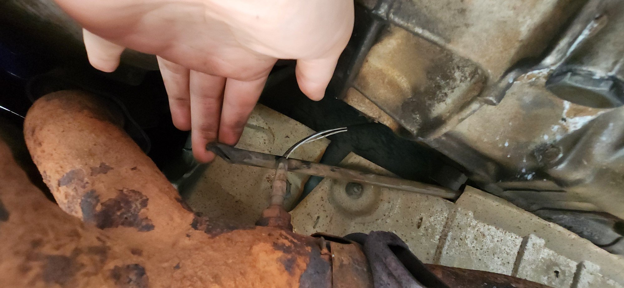

It is after firing like crazy and it was so bad it blew apart the muffler as seen on the pictures attached

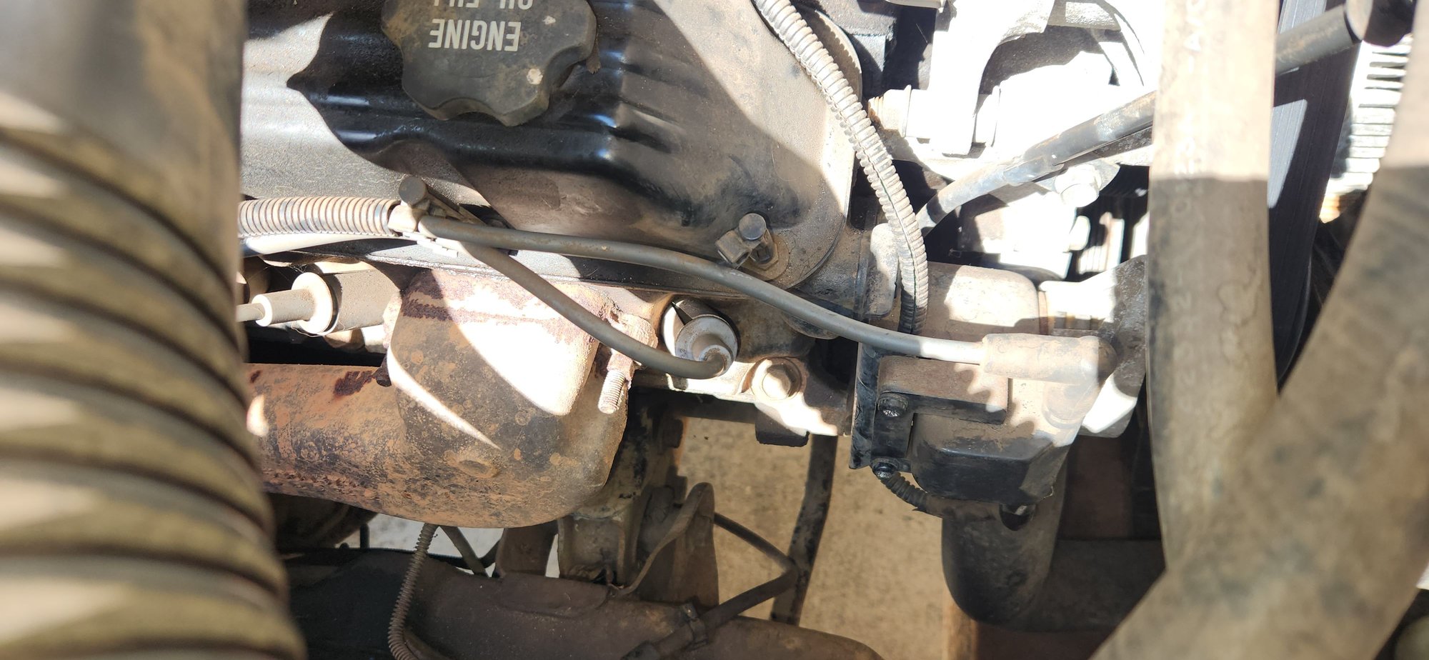

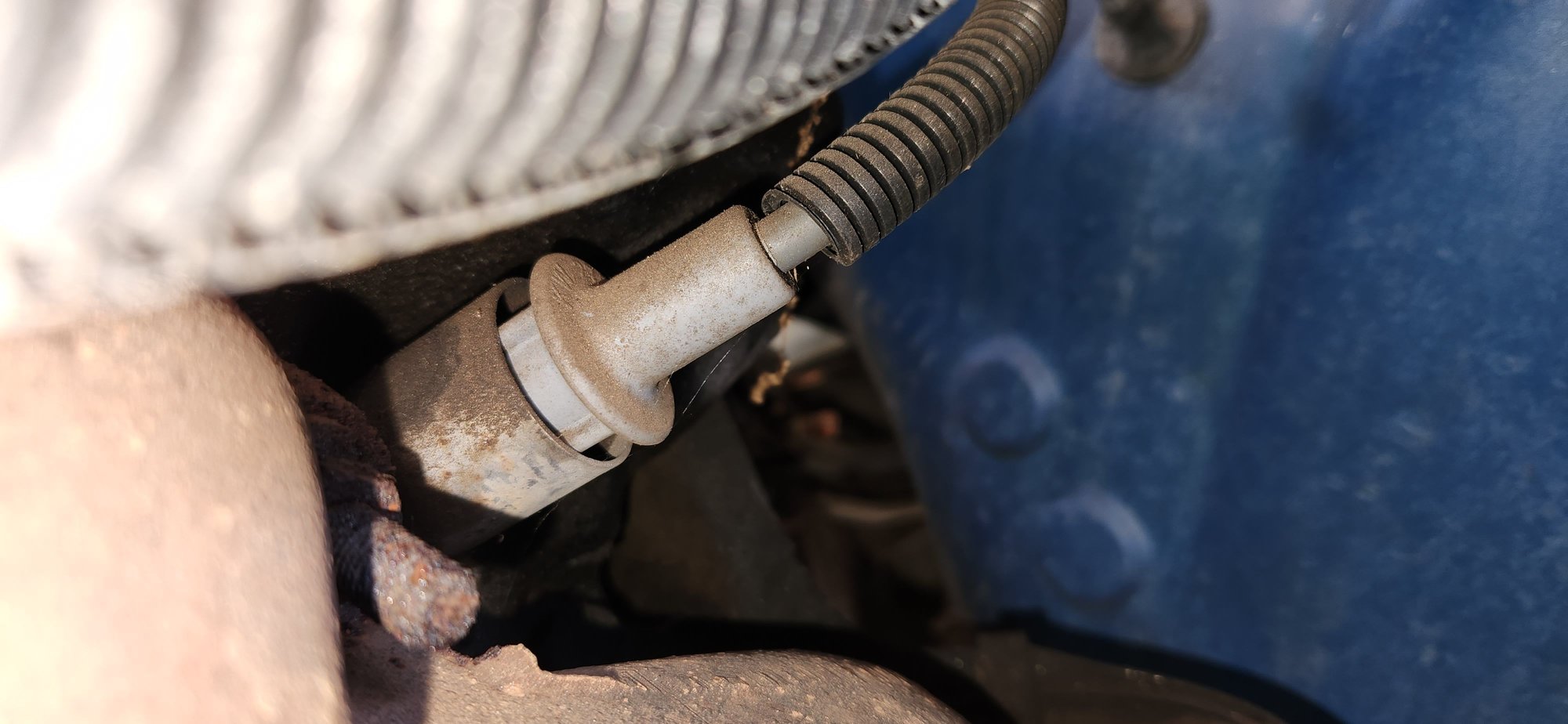

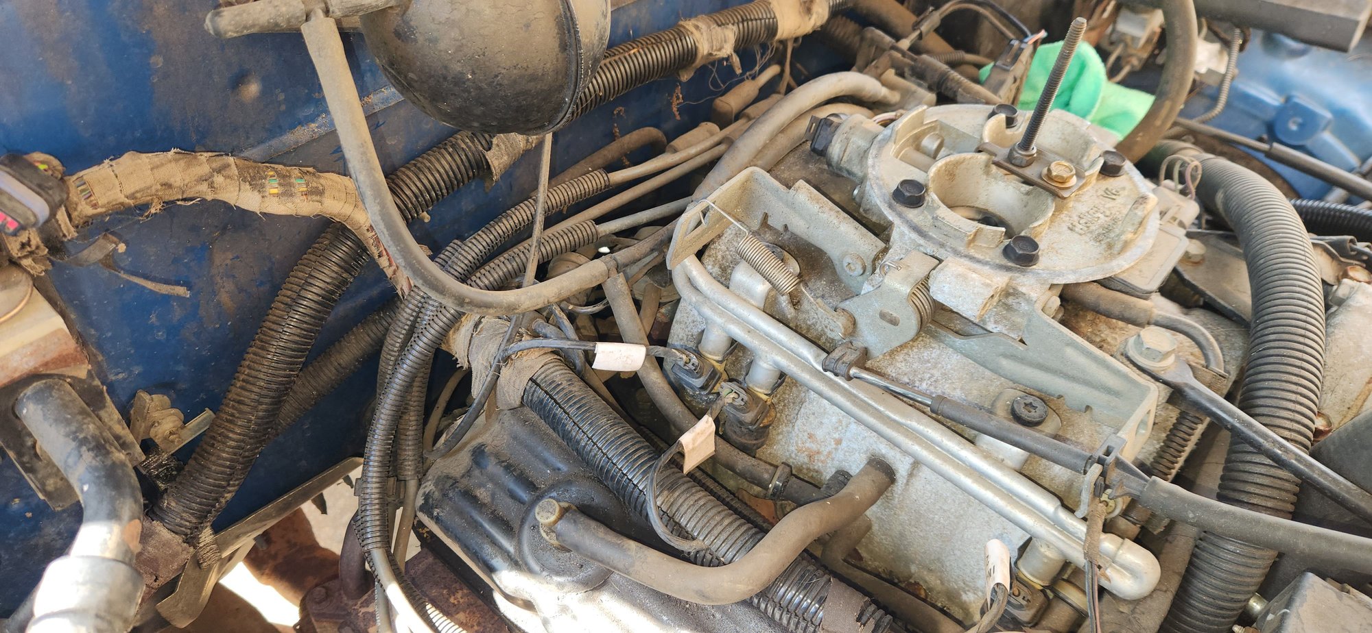

Also where does this hose go and or do it is attached to the top.

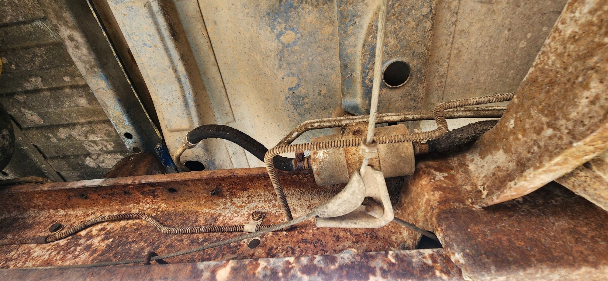

The previous owner said he put a new fuel pump in. Ill attach a picture showing the filter ABOVE ^^ though it looks like it could be replaced.
Any help would be greatly appreciated boys, thank you for your time.

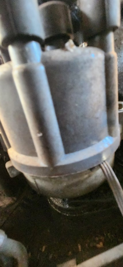

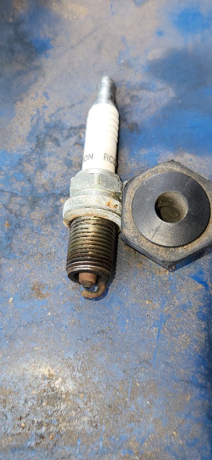

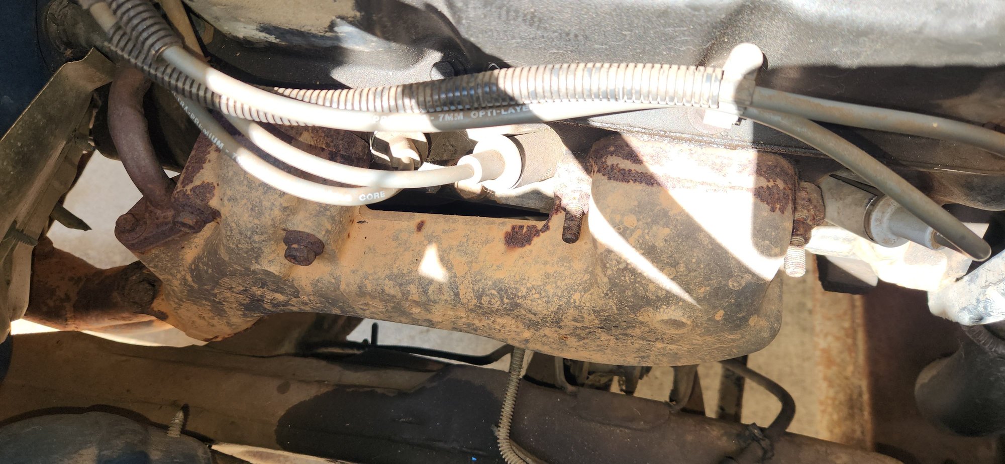

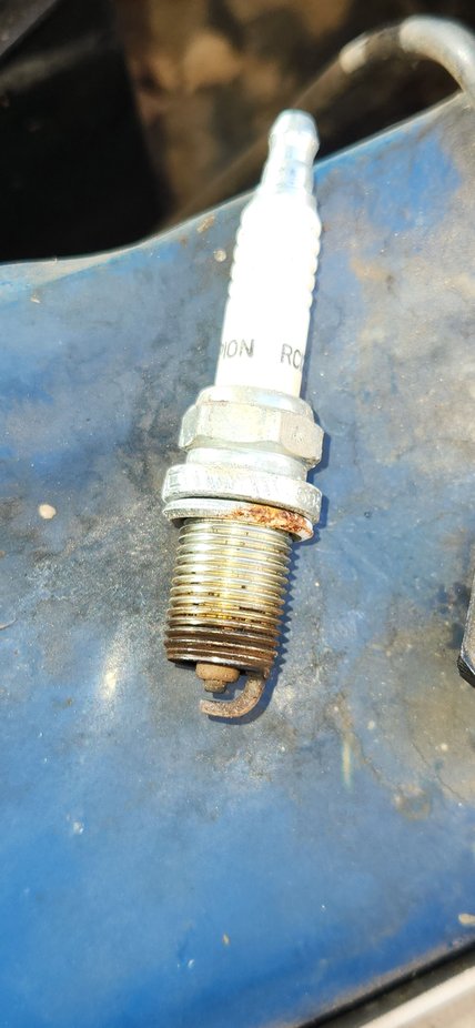

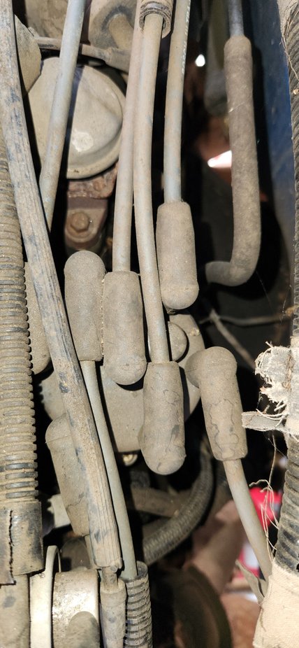

Default Spark Plugs and wires

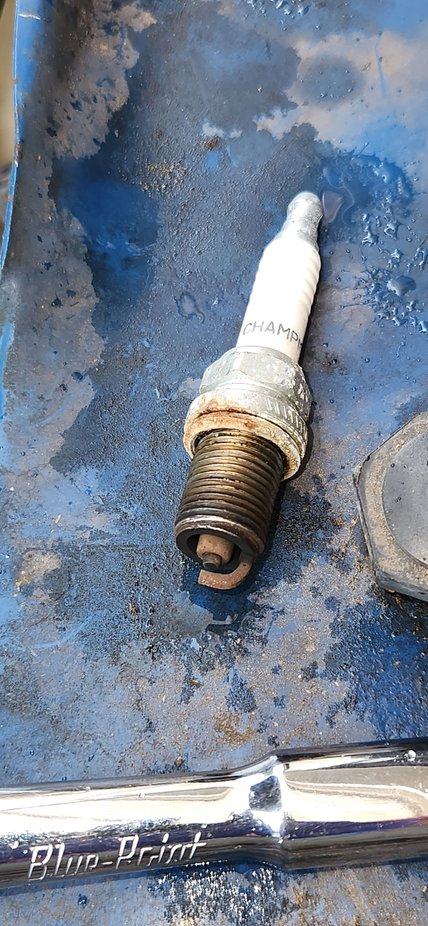

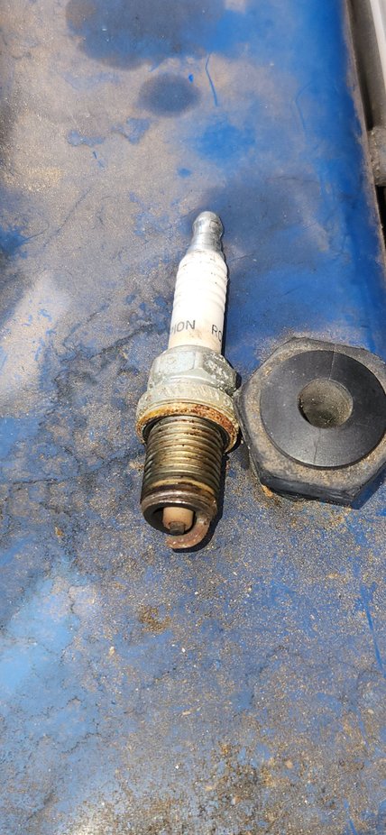

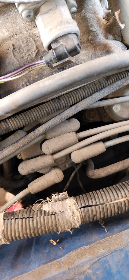

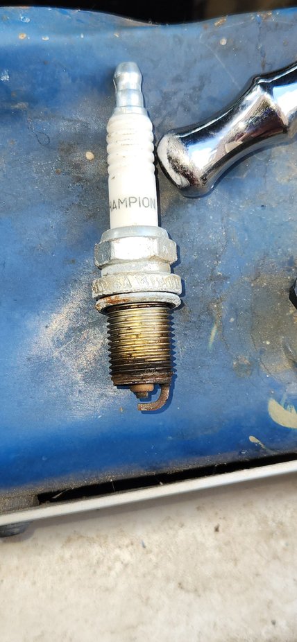

I checked the wires and plugs and to my limited knowledge they do not look terrible.
I did not take apart the Distributor though.
Passenger Side
Passenger Side
Passenger Side
Passenger Side
Passenger Side
Passenger Side
Driver Side
Driver Side
Driver Side back
Driver Side back
Alternate angle
Alternate angle
Top Dis cap
Top Dis cap
Back of cap
Back of cap
Old Jul 24, 2025 | 08:00 PM
Posts: 87,483
Those guys look a bit worn. Wouldn't hurt to throw some new ones in there. Copper plugs only please, brand of your choice.

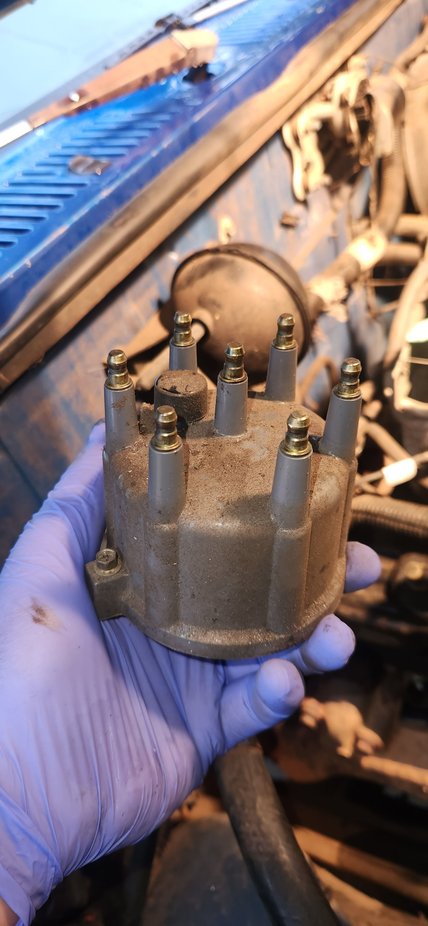

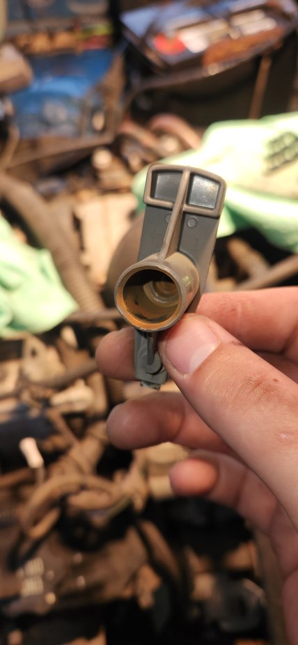

I suspect you have more than one problem going on....... REALLY need to check the cap/rotor as well.

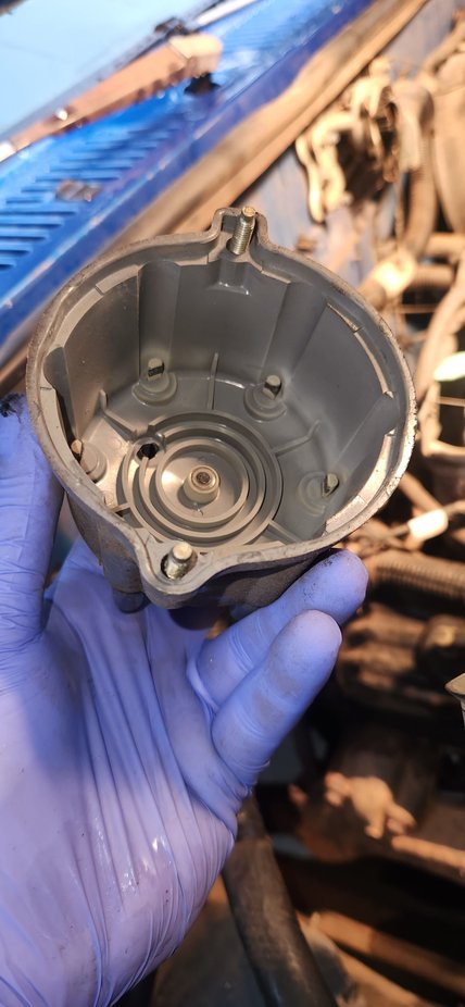

Old Aug 4, 2025 | 10:30 AM
Krycerick's Avatar
Krycerick
Joined: Jul 2025
Posts: 7
Default I am back from vacation
I am back from my trip and some parts have arrived.
I have replaced :
Spark plugs, and wires
Throttle Position Sensor (TPS)
Idle Air Control (IAC) Valve
Ignition Coil
Distributor Cap and rotar
I will post pictures below of the distributor cap, and a new video of how it runs.
Overall it seems to idle much better but with a little gas it is after-firing terribly still.
