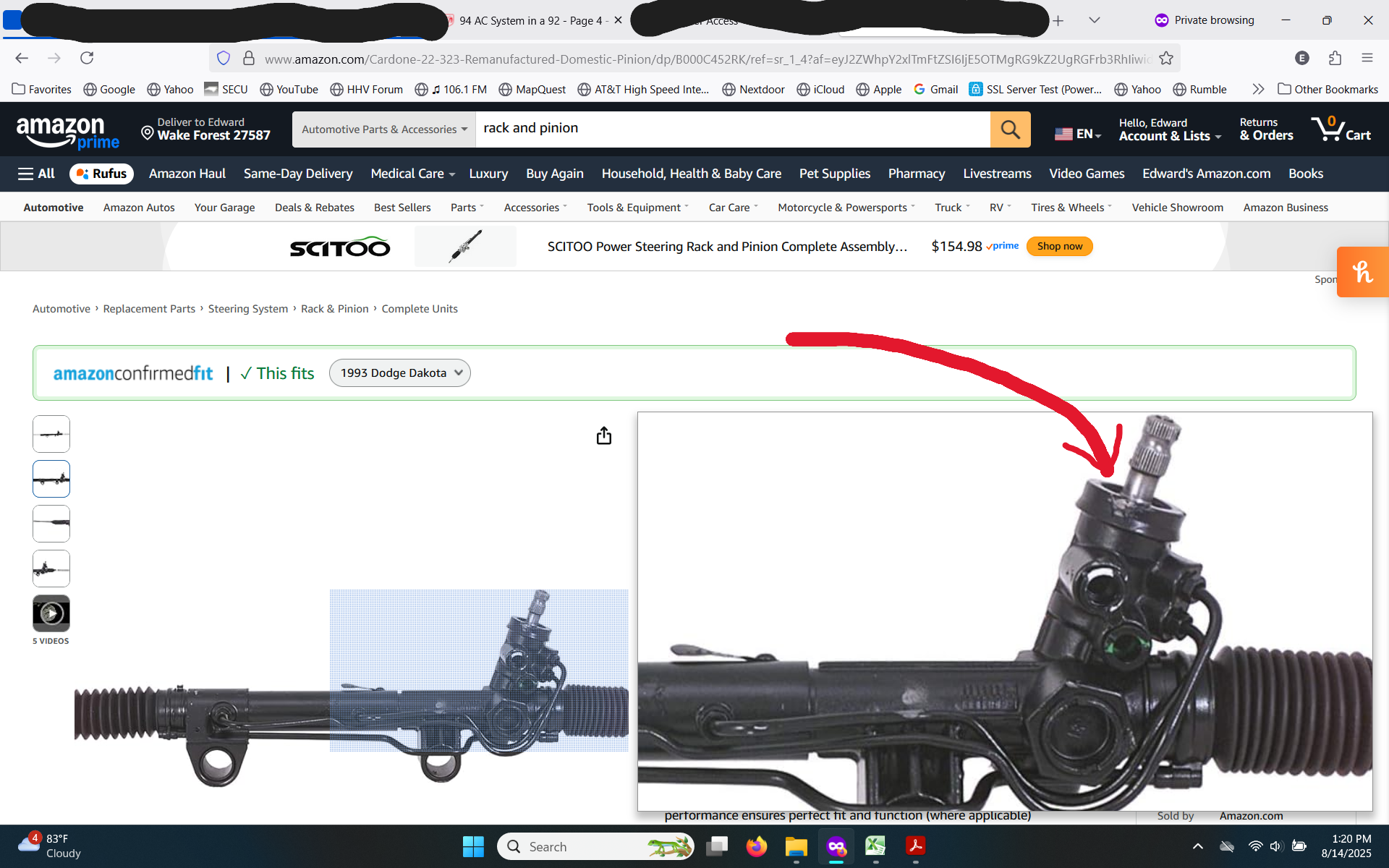

OK, good news-bad news-good news
For the first good news, I found where the leak is. The bad news, it isn't just a loose fitting. It is the rack itself leaking at the top where it meets the steering column (see arrow in screenshot below). The second good news, the leak seems to be slowing considerably. Perhaps as I get more of that Lucas Stop Leak circulating it is doing its job. I have, at the very most, 12 oz of that Lucas in there. Probably 8 - 10 is realistic. The instructions say it will need 12 - 24 oz. I don't believe in snake oil remedies but I researched that Lucas Stop Leak extensively. I read reviews and watched a bunch of You Tube vids and, to my surprise, it received pretty good marks. So i think I will give that Lucas more time to do its thing. Maybe I'll suck out the fluid from the reservoir and refill with the Lucas instead of just waiting for it to drip out.
I've seen that before. The bearing on the shaft is worn and is wallowing out the seal. Your rack needs a rebuild. There's a lot of stress on that bearing when you turn at slow speed. It eventually just wears out.
