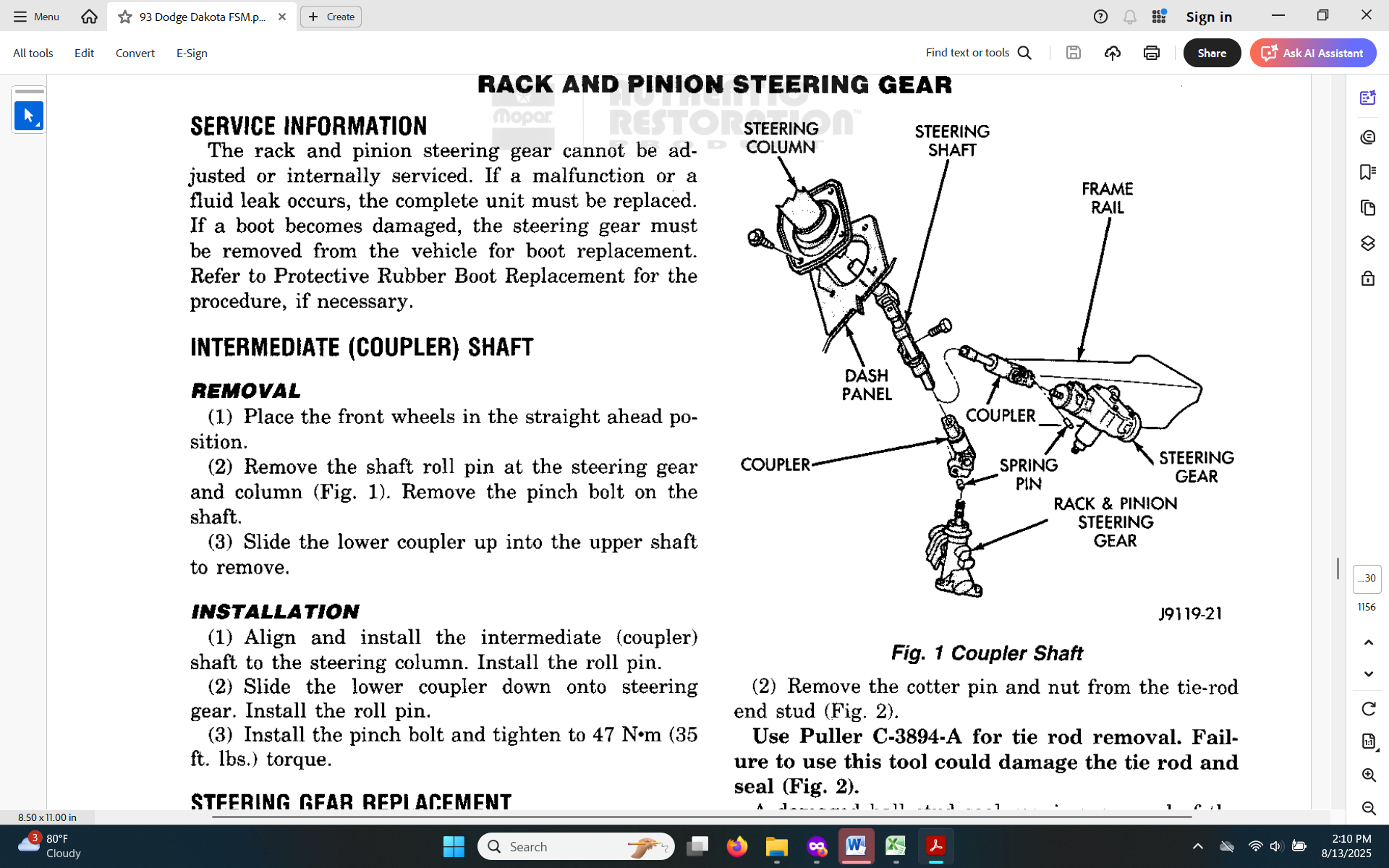

So I revisited my FSM. It shows a "Spring Pin" or a "Shaft Roll Pin" (depending on if you read the text or look at the picture) in the coupler (that couples the gear to the steering shaft) that has to come out at the steering gear. Looking down there I see little/no way I can even get at that pin. Not from above or me rolling around the floor. I still can't see that pin because from above it is blocked by that u-joint just above it. From below there's a bunch of crap in the way tho I'd like to get my full body under there and give it another look from below. That pin is the only daunting task on this job. I'm wondering if I could remove that pinch bolt and keep the lower shaft attached to the rack when I pull it out. Getting to that pin would be a lot easier working on the bench than on the truck. Thoughts?

I watched that video a few years back. Yeah, that's a different design than mine. He has that clamp thingy around the bottom of the steering shaft. You're supposed to be able to loosen that and slide the drive shaft up. He said he got it to slide an inch or less. I have that same clamp thingy on mine but its way above the rack (about 8 - 10"). I read somewhere that this roll pin design I have was around for only a couple years or something and I'm not sure if it was all models. They probably figured out what we did that it was a dopey design and went back to the previous version. I just happened to fall in that 2 year window. I just threw 1/2 oz of dye in the power steering reservoir and drove it around 10 miles. I'll take a look in the morning to see if I can pinpoint the leak. With any luck it will be a loose fitting or hose. Thanks, Grouch. I appreciate your insight.
