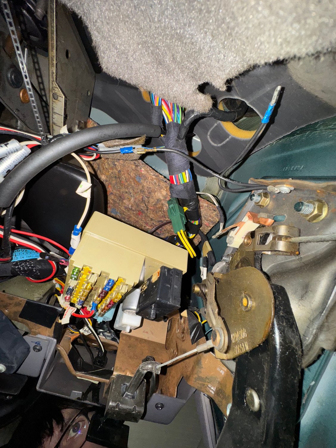

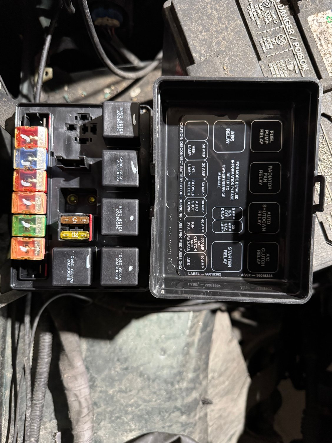

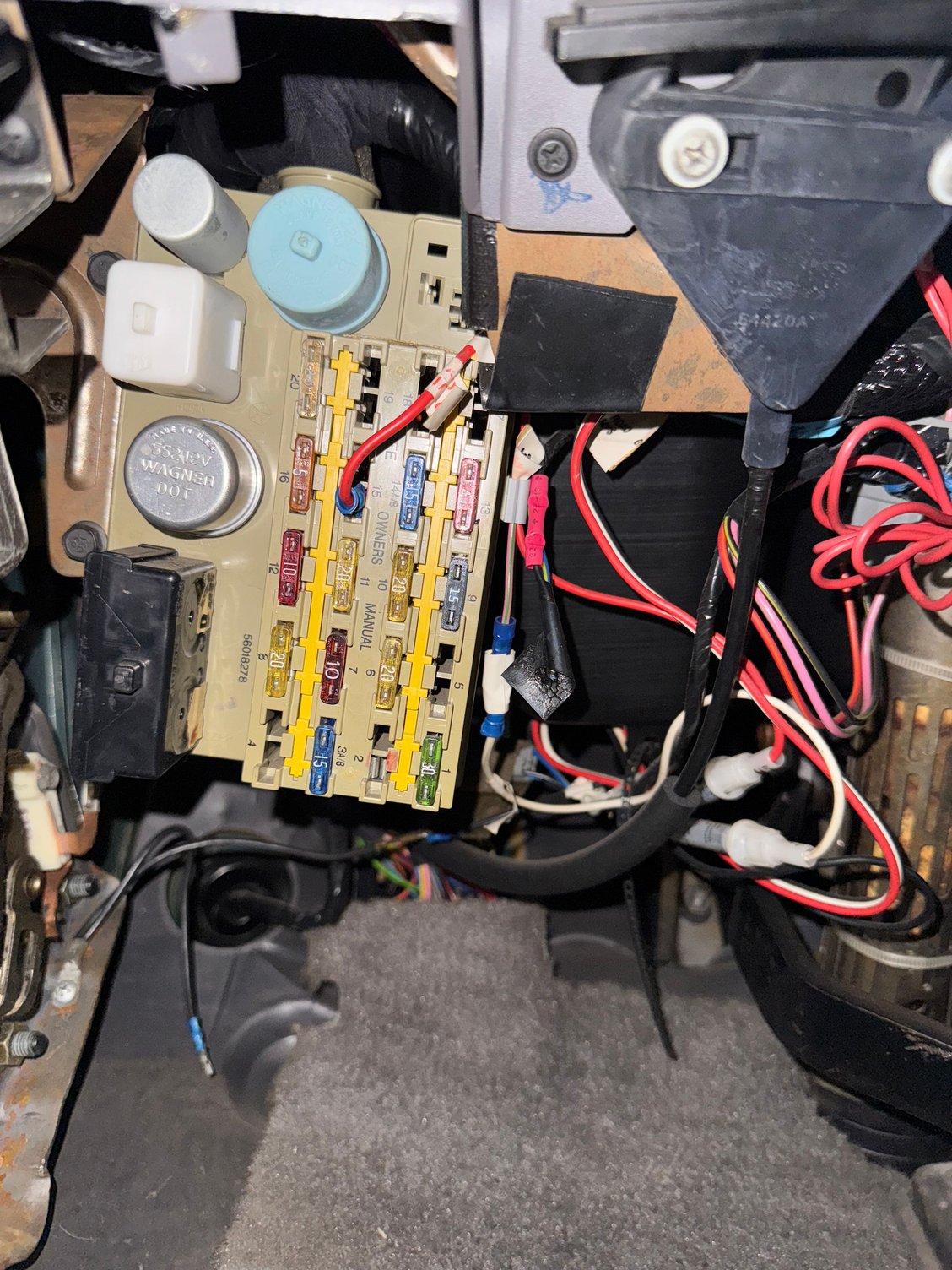

Default parking light switch not working
I just bought a 1996 Dakota 2WD V8 5.2L, and all my lights work (besides fog), but when I go to switch on my parking lights, they don't turn on, but I know they work because when using a blinker or my hazards, they turn on. I'm not sure how to locate the wire or fuse for that specifically, and can't find much help on Google. Any help/tips would be super appreciated.

do the dash lights come on? on my 92 the number 8 fuse is for headlight switch and #20 is for fog lights and for park light relay. not sure if 96 is same as 92 wiring

I would not discount a failed headlight switch or wiring harness plug. You should pull the switch loose and examine it and the harness plug. They do get burned.
