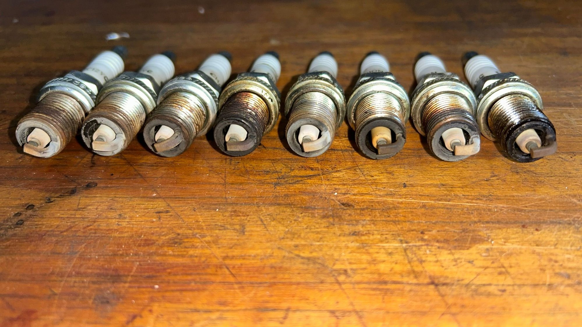

Old Mar 30, 2026 | 02:48 PM

Old Mar 30, 2026 | 03:04 PM
Posts: 87,399
Likes: 4,214
Some of those are awfully clean.... (burning lean.) Third one in from the right is the color you really want to see. No oil fouling though, and that is most certainly a "Good Thing".......
Old Mar 30, 2026 | 03:27 PM
bronze's Avatar
bronze
Joined: Nov 2015
Posts: 2,232
Likes: 473
From: North Carolina
1,2,5, and 7 are real clean. Can the fuel trim (assuming long term) be adjusted or is that hard programmed in the OBD1? Or does it go beyond fuel trim...perhaps injectors or something else?
Old Mar 30, 2026 | 03:34 PM
Posts: 87,399
Likes: 4,214
O2 sensor should correct for that..... but, apparently, it isn't being that on the ball. If I were really concerned about it, I might consider some flow-matched injectors, but, if the engine runs good, I likely wouldn't bother.
Old Mar 30, 2026 | 03:37 PM
Yeah, I don't really notice anything, rough riding, hesitation, or anything like that. Perhaps the only thing that bothers me with the way it runs is I get some light knocking when driving up a hill. Had that knocking even after pulling and cleaning the snot out of the throttle body.
For the record, I replaced the original oxygen sensor in 2018 (22,000 miles ago) with an NGK 23023 sensor. If I'm not mistaken this was the OEM sensor?? I have only one oxygen sensor located pre-catalytic converter.

Old Mar 30, 2026 | 04:48 PM
Posts: 87,399
Likes: 4,214
If you are getting spark knock, you may wanna consider some matched injectors..... I wish the PCM would track which cylinders are knocking... But, I don't think dodge discovered knock sensors until the third gen trucks came out.
Not sure what you mean by "matched" injectors.

Old Mar 30, 2026 | 07:38 PM
Posts: 87,399
Likes: 4,214
"matched" injectors all flow the same, for any given pulse width. Stock injectors can have a pretty wide flow range for the same duration.... Flow matched injectors all flow very close to the same amount of fuel. Don't think spray pattern really matters overmuch in these engines though. Stock vs four, or six hole injectors don't make a noticeable difference..... Stock fellers are pencil beam, they shoot a stream of gas directly at the back side of the smokin' hot intake valve, with effectively vaporizes the gasoline. Really not a bad idea, it works, and severs a secondary purpose of cooling the valve as well.
