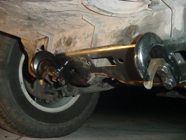

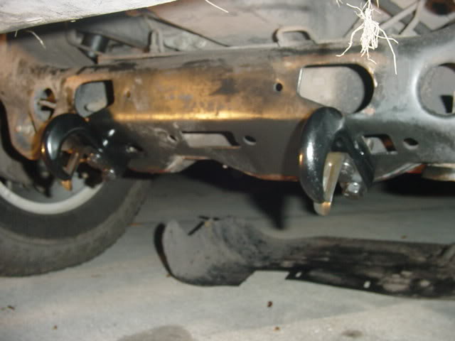

yay tow hooks
temporary until i get the wincher bumper, there is no other place to put them, i put my d on a lift and spent close to 3 hours looking it over and mocking it up, nothing else works, just cant get to stuck :P
oh and that crossmember the same thickness steel as the frame, i also was able to get some sheet metal plates made and put them in behind the hooks in the crossmember, so hopefully that should help reduce the risk of damage

Those tow hooks look friggen awesome!!

got them form a local, truck/suv supply store, $15 each, came with the lil rope holder and all mounting hardware
