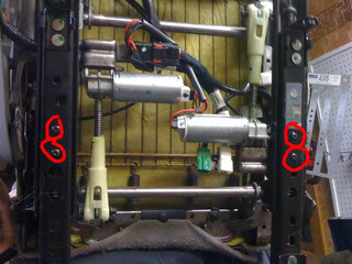

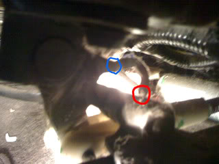

So, I finally took the time to get around looking at mine, the drivers seat is f***ed up.
the blue is where it bent and the red is where it broke, so it just rocks back and forth, I'm thinking about getting a whole new seat for that since my heat seat is shot in that seat.

my passenger seat, wasn't so difficult, once it was out we realized that the 4 screws that hold the track to the motorized thing fell out and were sitting right under that seat, easy as pie.
the 4 red circles here are the 4 screws, a little lock tight and they should be good to go.
this is what the piece the broke looked like.
That piece that broke off, you will have to weld it based on the first initial fix of the rocking seat on the first page of this thread. That piece that broke off is part of the assembly. Maybe you can have someone reweld that piece onto the bar or basically build a new plate and reweld it to the broken plate???
Your passenger side, it's odd that the 4 screws came off? I guess that is how you are now sliding FULLY front/back and vice/versa! haha
well, how well do you think welding that will hold? I would like to get this fixed, no matter what the price, and be done with it, haha, the cheaper the better but I want the assurance of it not happening again, it's really annoying.
