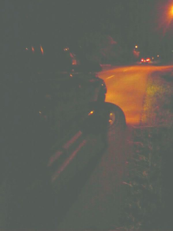

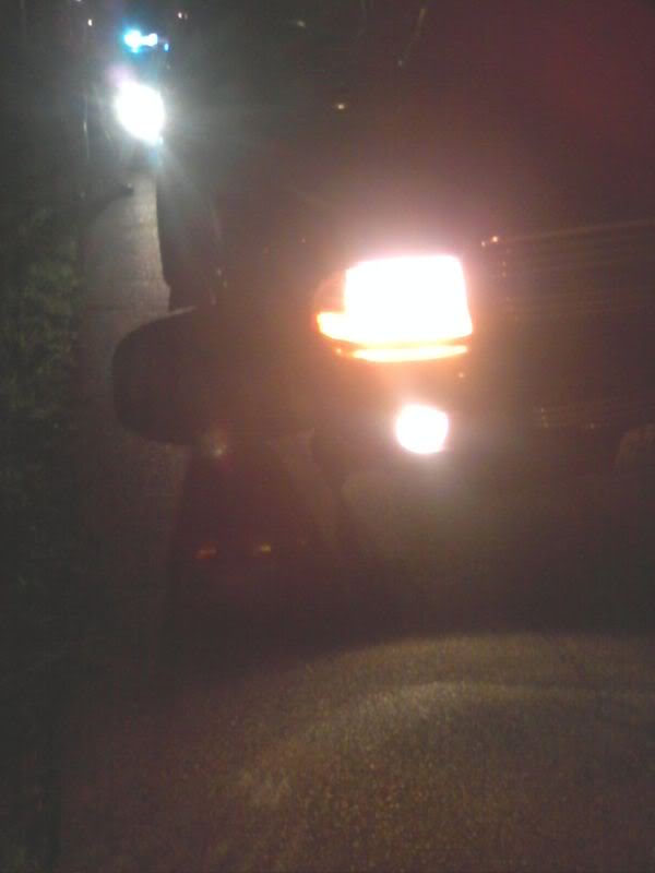

oh btw~ if you do take the spline part out of the hub after redoing ball joints and a 12 pack of budlight this will happen i made it 15 feet out of the driveway broke my hub/spindle/steel braided brake line/ and my heart boo hoo
