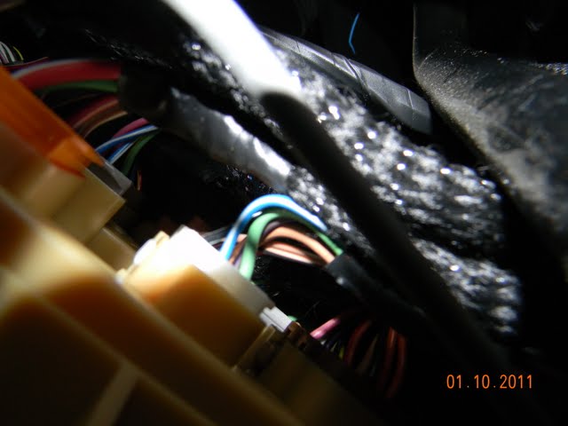

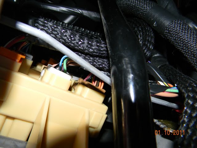

it does not exist on the newer dash design, i just went out and checked mine, i have pictures if anyone wants to argue it with me

i have 29 fuses listed on that panel in my truck ill add my pics soon as i get em up

ok since theres another post ill just put the pictures here so that nobody misses them
(the labels for each fuse)
and these last two are pictures up behind the primary fuse panel, nothing but the plugs for the primary panel back there
even looking in my owners manual doesnt show any mention the 'special' fuse panel behind the primary
