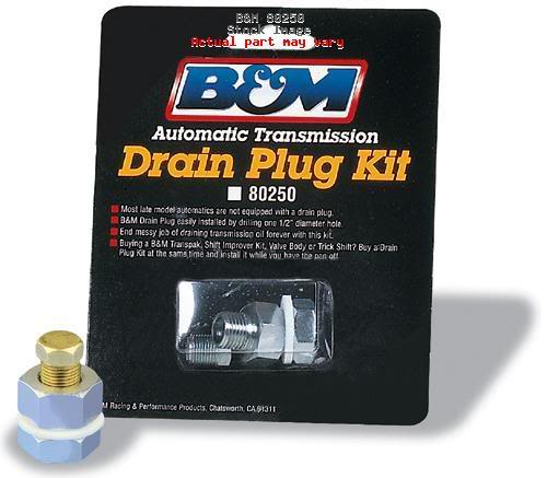

Do a change.
The OEM is ATF+III but the Fully Synthetic version that replaced it is ATF+4.
You will need to drain, fill and run 100 miles and drain filter and fill.
Since you will be filling it up you might what to install this into the OEM pan to make it drain like a oil pan.
I need to put one of those on my pan.. been meaning to but just have not done so yet.

There so nice!
Better if you can tack weld the nut while it's out.
