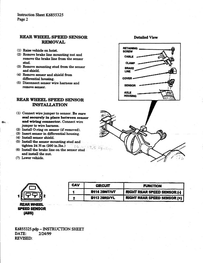

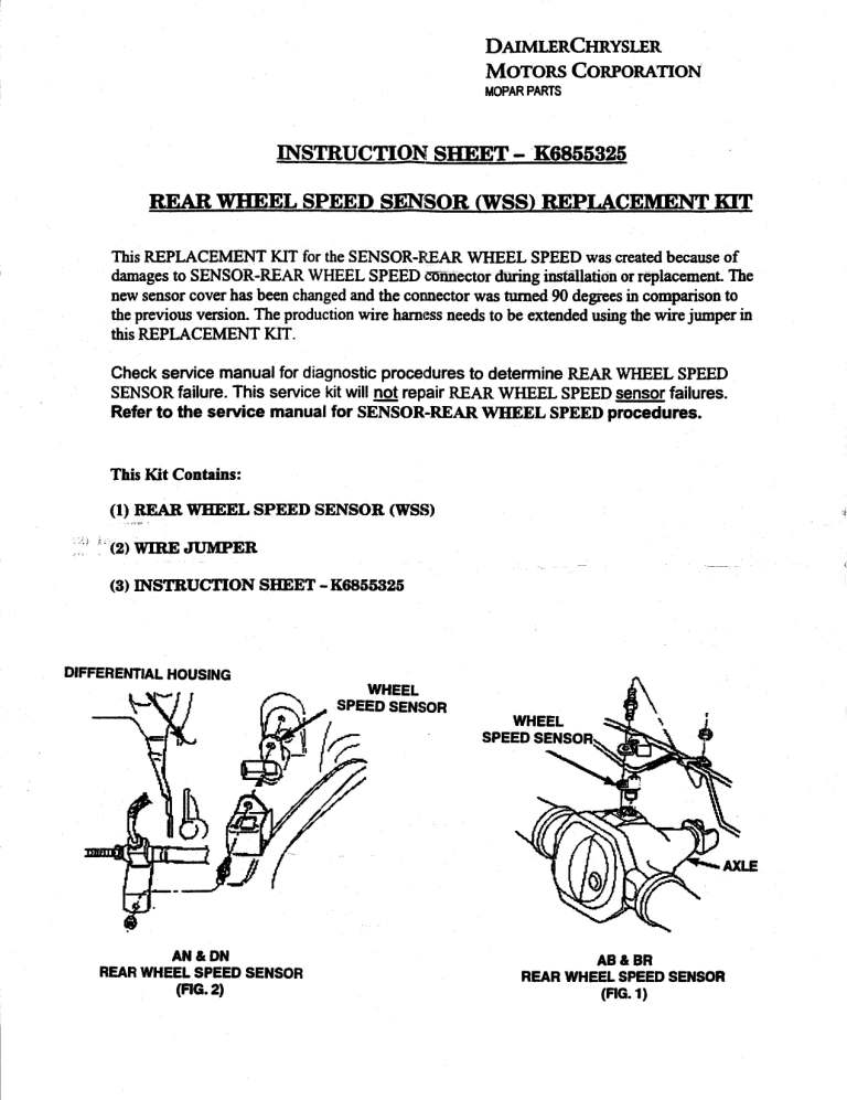

Hi all,
I have been searching the web to find a solution for my 98 Dodge Durango. I went to Checkers to get the ABS Rear Speed Sensor, but it was the wrong one. I searched and googled for a place to buy and came up on this site: http://www.wholesalemopar.com/. I paid about $27 for the part and $10 s/h (total $37). I think I used a combination of forums to find a solution.
I also scanned the installation document, since I saw a lot of owners asking for a diagram. Thanks for the help!!!
