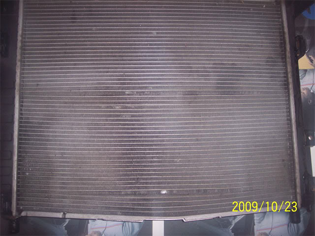

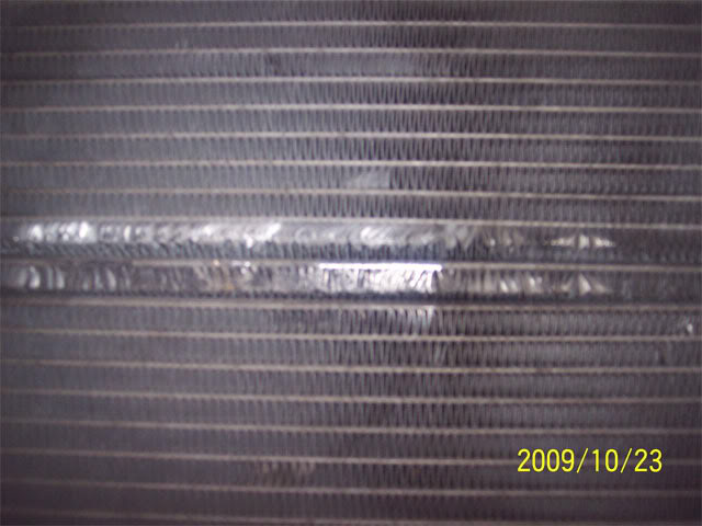

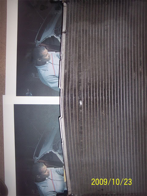

Here they are. Obvious pressure build up pushed the radiator apart. It was a swollen mess indeed.

WOW...I've never seen anything like that before. Pressure build up.....from what? The only thing that would cause that kind of pressure is a head gasket. the cooling system should never create that kind of pressure. pretty sure the 10 year old rubber hoses would give way first.

He had new hoses and a VERY tight rad cap on a new "Jegs" neck. Why? Long story but all in all it replaces the plastic neck with a metal one. I have the same thing. It is better than the plastic BUT it seems to be too thick and doesn't allow the cap to rotate or pop off from pressure. Obviously that is a pressure situation, coupled with an old, hot, softened, weakened radiator and POP!
Never seen one like that either BTW! WOW!!

Indy nailed it!

You don't have the same neck keeping the pressure from releasing. Don't be (as) worried. I have NEVER seen one do this... and I have the same same neck but with an all new rad.
