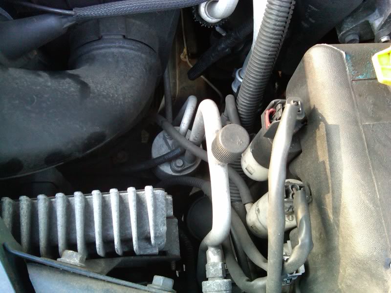

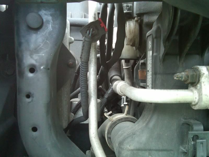

But on my 4.7L, there is NO room for anything up by the front of the car. as Indy said in that thread you posted above, the transmission controller is located there, and also there are A/C tubes and some sort of solenoid(?) in the way.
as you can see, its ridiculously cramped in there... its really annoying.
I'm still trying to rig something up so I can get a ram air of sorts even with all that crap in my way (and with my custom cai). I'll make sure to post pictures/details when I figure it out/get it done! (also if you have any suggestions, feel free to let me know! any help is greatly appreciated!)

Thunder, your setup on your CAI for your 4.7 is going over the side exactly like the K&N setup does for the 4.7s too. Just leave it there and consider an airbox or something like theirs. That's all you are missing.
