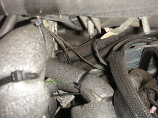

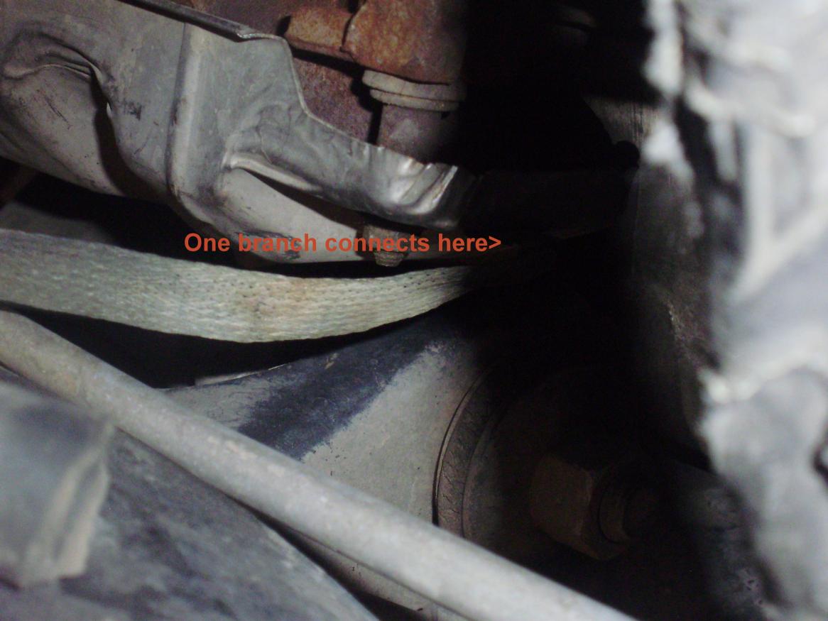

Now I have what appears to be a simple problem, but I can't figure it out. There is a flat braided wire that connects to the fender well on the body on the passenger side engine compartment. From there it branches in 2 directions. One goes directly to the engine. The other branch connects has a connector that isn't connected (THE PROBLEM) and then connects to the firewall as a ground I presume. I have reviewed the Haynes manual but haven't had any luck since the pics aren't all that good. Wiring diagrams there are great but don't really explain to newbies exactly where the connections are. This is probably about a 2 second problem for anyone with a clue, and another hour trying to explain to me where it connects. I'm no genius but I'm motivated. Any help? Hopefully the attached pictures help explain.
Thanks in advance for the help. I expect I will be a regular problem poster here on the forum.
Attached Thumbnails Braided, Flat Wire Connection Question from Newby-p9260093.jpg   Braided, Flat Wire Connection Question from Newby-p9260094.jpg   Braided, Flat Wire Connection Question from Newby-p9260095.jpg   Braided, Flat Wire Connection Question from Newby-p9260096.jpg

HI Brian, welcome to the site. I have a 2001 4.7 too. Looks like you have an aftermarket air intake. I think the loose ground is supposed to connect to the frame from underneath the stock air box. Here's a pic. #1 looks like it's connected to the frame. #2 looks like it goes under the stock air box. HTH. If I got it wrong, please don't flame me.

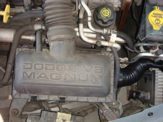

Thanks for the compliment, Brian. There are much cleaner engines out there, believe me! It's all in the flash! Here's what a stock airbox looks like on the 4.7:
It's a rectangular shape about 6"X11". The more I look at it, the more I think the braid goes under the airbox location. If you don't get a response proving otherwise, I'm gonna look inside my engine bay after work to make sure. Please disregard that travesty of a cold air intake. I have since corrected it!

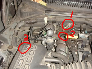

Okay, I think I've found the loose conenction. I took some pics so here goes:
Ground overview:
#1 is the firewall ground
#2 is the loose connection

#3 is the connection under the airbox, just like your first pic, Brian

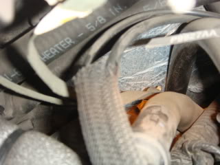

Here's a closer look at where the loose connection should look like. It should be right under the 5/8 in. heater hose shown here and beneath the two cables wrapped in braided hose.

Thanks to all for your effort in such a trivial problem.
Dan, I think you are right on in where it connects. The length matches. It looks like on yours, it has a connection on the valve cover close to the firewall. I can't see exactly, but that's what it seems like. However on hers I can't find anything in the vicinity to attach it too. I'm gonna keep looking and will let you know what I find. If any of you guys happen to run across it while your working, let me know.
