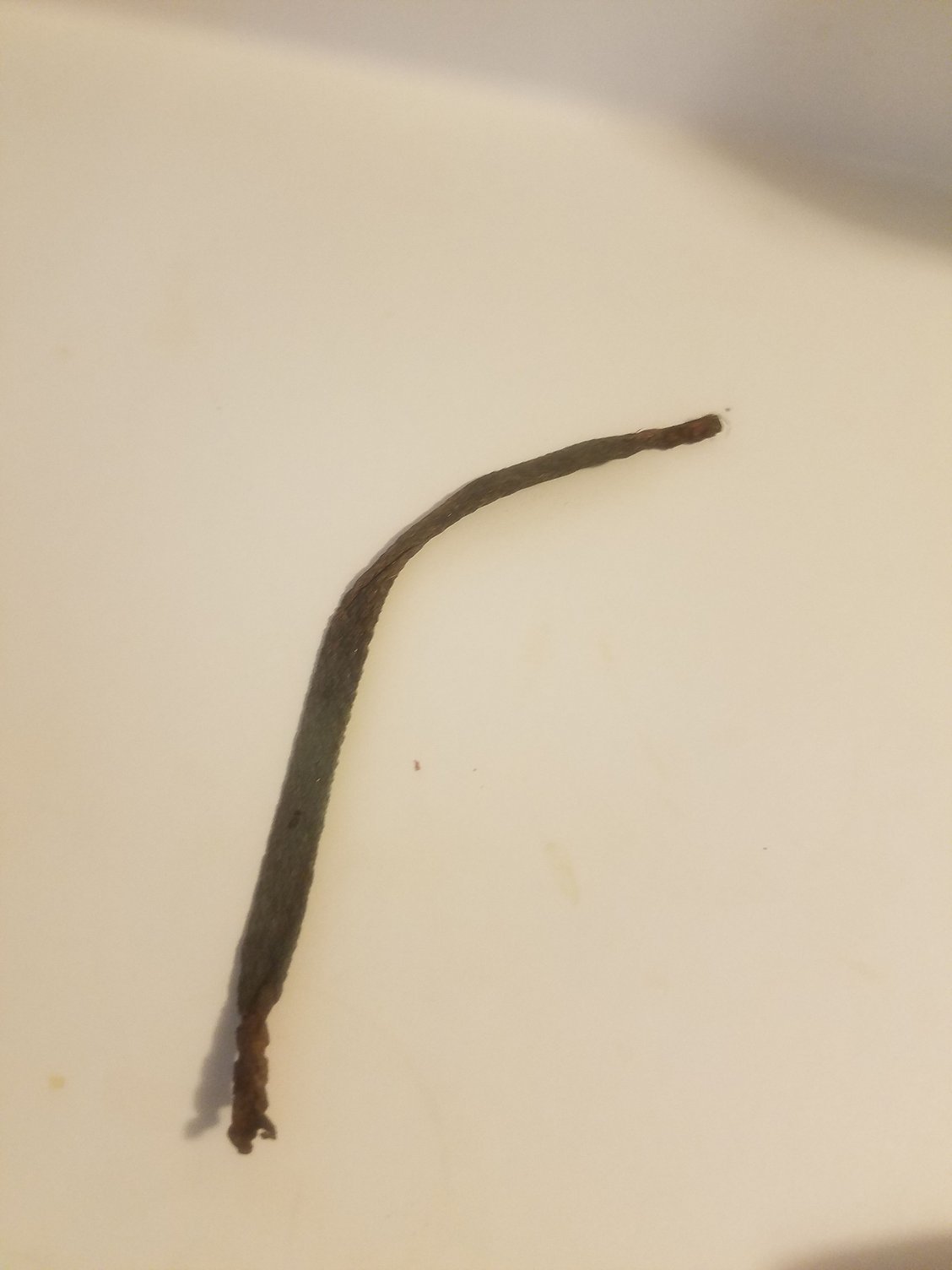

I'm having the same problem. I found one of these wires laying in the ground under my 2007 Dodge Charger. I cannot figure out where it was at. Car has been overheating. I have the 3.5....any idea how to figure this out? I've been researching for 3 days now with no luck.
Old Jun 28, 2020 | 01:30 PM
Posts: 87,453
Likes: 4,218
It's a ground strap. I seriously doubt it has anything to do with overheating.
Check the back of the heads for a ring terminal with nothing attached to it.

Thanks so much for your time! I will go look now!

I'm about to go get a new one and connect it to the 2 bolts at the arrows. Thanks so much!

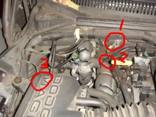

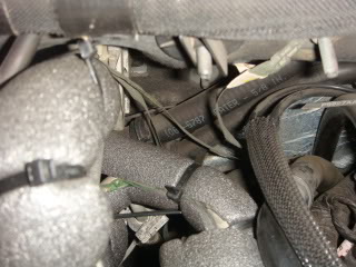

Originally Posted by Dans01Durango
Okay, I think I've found the loose conenction. I took some pics so here goes:
Ground overview:
Attachment 98713
#1 is the firewall ground
#2 is the loose connection
Attachment 98714
Sorry, it was the best closeup I could get.
#3 is the connection under the airbox, just like your first pic, Brian

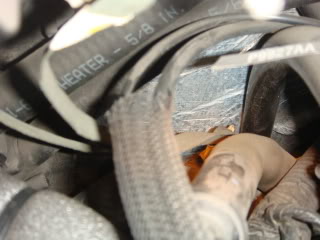

Attachment 98715
Here's a closer look at where the loose connection should look like. It should be right under the 5/8 in. heater hose shown here and beneath the two cables wrapped in braided hose.

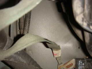

Attachment 98716
Sorry hydra, I couldn't pull the airbox. I got home late from doing OT and the pics were the best for now.
I am in desperate need of the serial number for that black plugin ground under the airbox. There are 3 wires connected in that position on my dakota, and one of them is a plug in module. I'm guessing it's a computer relay that doesn't seem to be complete the circuit. My ohm meter reads for all other grounds and the two other wires on that bolt. Does anyone have access to this piece to get a picture or a number.
