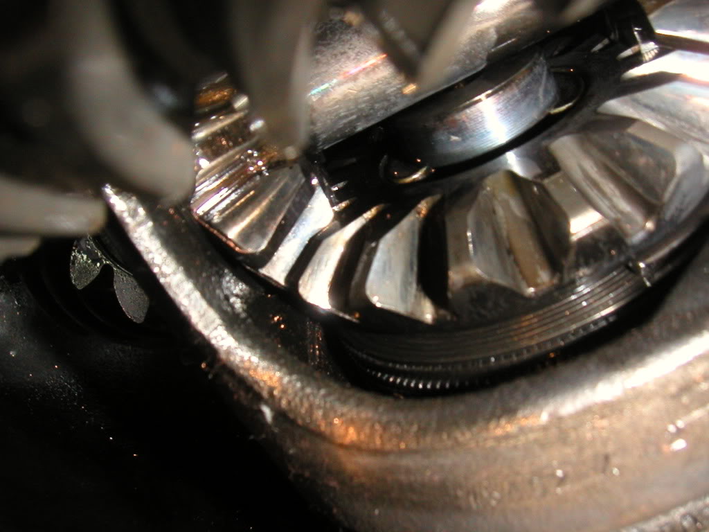

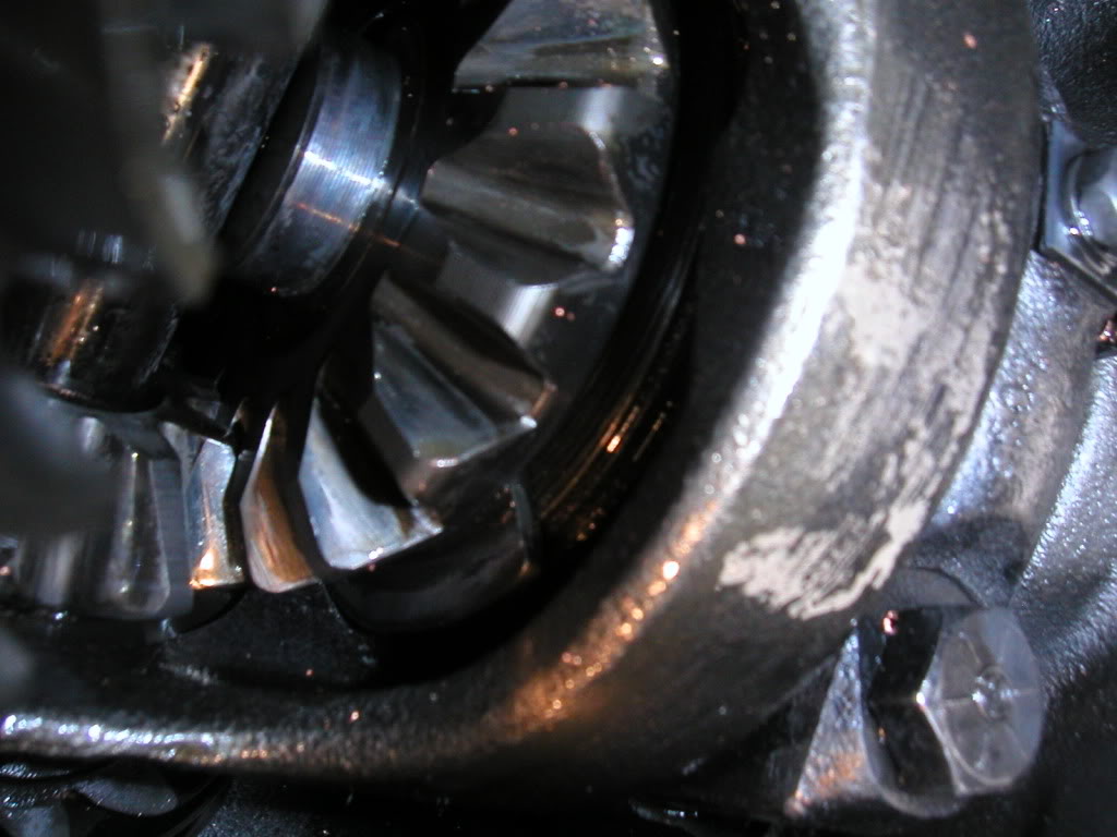

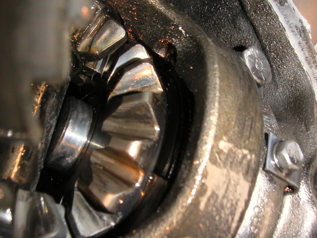

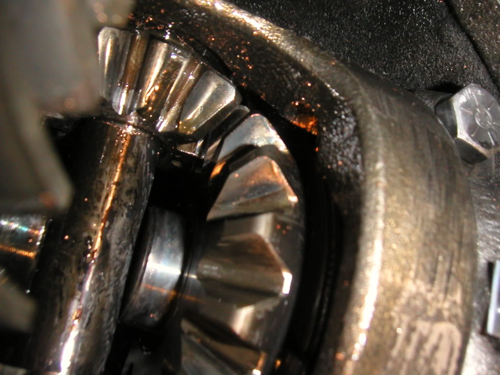

I went out to look armed with a mirror and a light. Well I found the issue:
A broken clutch pack!
I want to thank everyone that clicked this link and specially thank the members who contributed.
Because of the contaminants and because of where the truck is located I think it's going to the shop. I always wanted to do a DIY on the gearing but considering this is a Limited Slip Rear Differential it's most likely not going to be found in a junk yard a rebuild is in order. Now I get to figure how to pay for it and getting it to the shop not to mention finding a ride home so I can come back to grab the family that is stuck with me here as well.

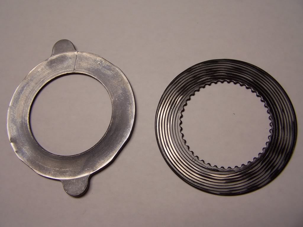

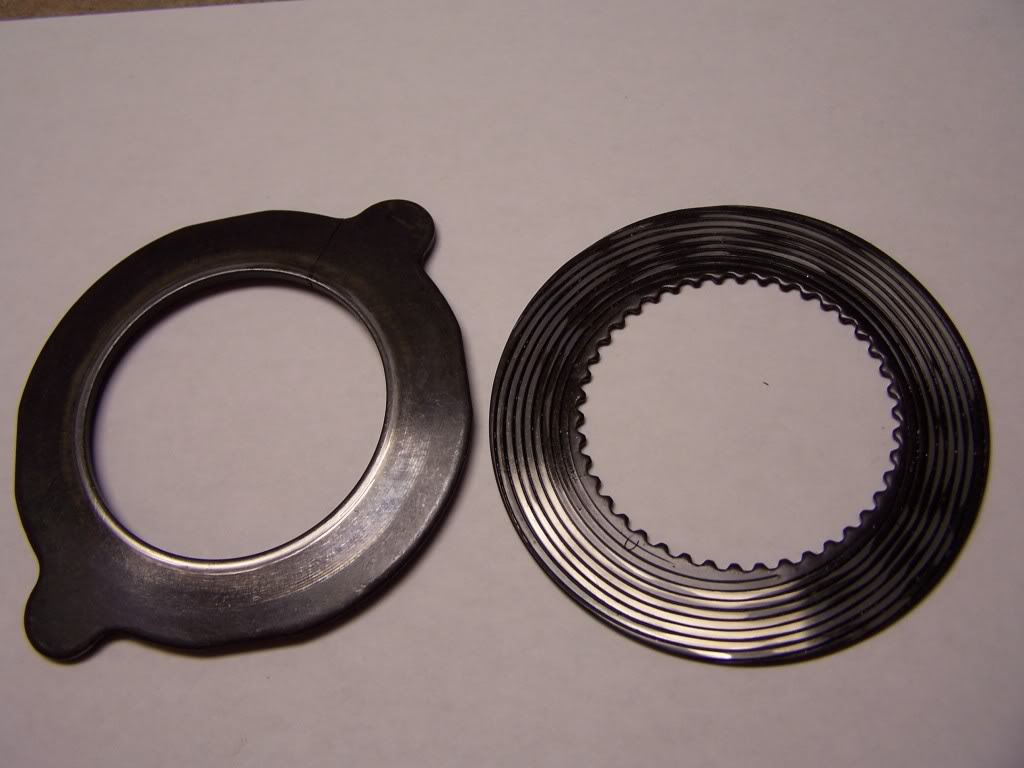

I completed an entire rear end rebuild including Pinion bearings and seal, Wheel bearings and seals, and Differential, Differential bearings and Clutch Packs, and ABS Tone Ring. The problem was actually a broken Belleville Spring from fatigue and not from a maintenance issue.
The clutch packs showed ware but there were no observed maintenance issues. In my post to Indy above ^ #13 ^ it stated that I had about 30K on the lubrication. This is incorrect! The correct mileage was found on the diff cover and verified on my receipt at being 121k and the truck had 174,500k thus leaving 53,500 miles on the lubrication. I had forgotten to change the lubricant at the 30k mark as I like to do. OEM states that the gear lubricant needs to be changed every 60k but we as forum members like to change it at 30k and recommend that people change at 30k intervals. However, the manufacture states that it should be done every 60k.
Here are 2 pictures of a used clutch pack (that does not show much ware but you can see one Belleville Spring cracked from fatigue and not lack of maintenance. The other side was broke in half so I didn't picture it:
