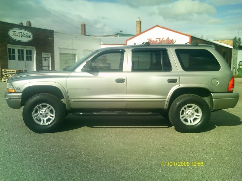

Hydro: I used the Add-a-leaf from BDS Suspension Part Number 119159. It is what the off road shop has been using for Durango's but originally for like a 90 dakota or something. I dont have any pictures of the leaf itself. Did you want me to take a picture of the leaf pack on the D with the Add-a-leaf in it?
Dodge R/T: Here are a few pictures of the D Before the Lift and after.
BEFORE:
AFTER:
