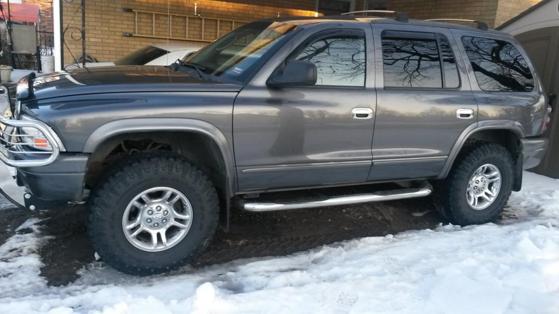

Ok here is my durango
Attached Thumbnails is a T/S lift worth it?-durango-side-2.jpg
Old Mar 8, 2014 | 09:59 AM
  #24
gvsu4msu's Avatar
gvsu4msu
Joined: Jan 2014
Posts: 215
Nice look. Running a similar setup myself . Btw , are you getting any rubbing on full turns? I noticed it on mine when either backing out of a parking spot or the driveway. I found it was the lower corner I side of the front bumper catching my tread lug.
Old Mar 8, 2014 | 12:53 PM
  #25
jjphurst's Avatar
jjphurst
Joined: Apr 2012
Posts: 82
From: Missouri
I did get a little at full lock but I trimmed the front bumper and inner fender maybe a half inch and that took care of it.
