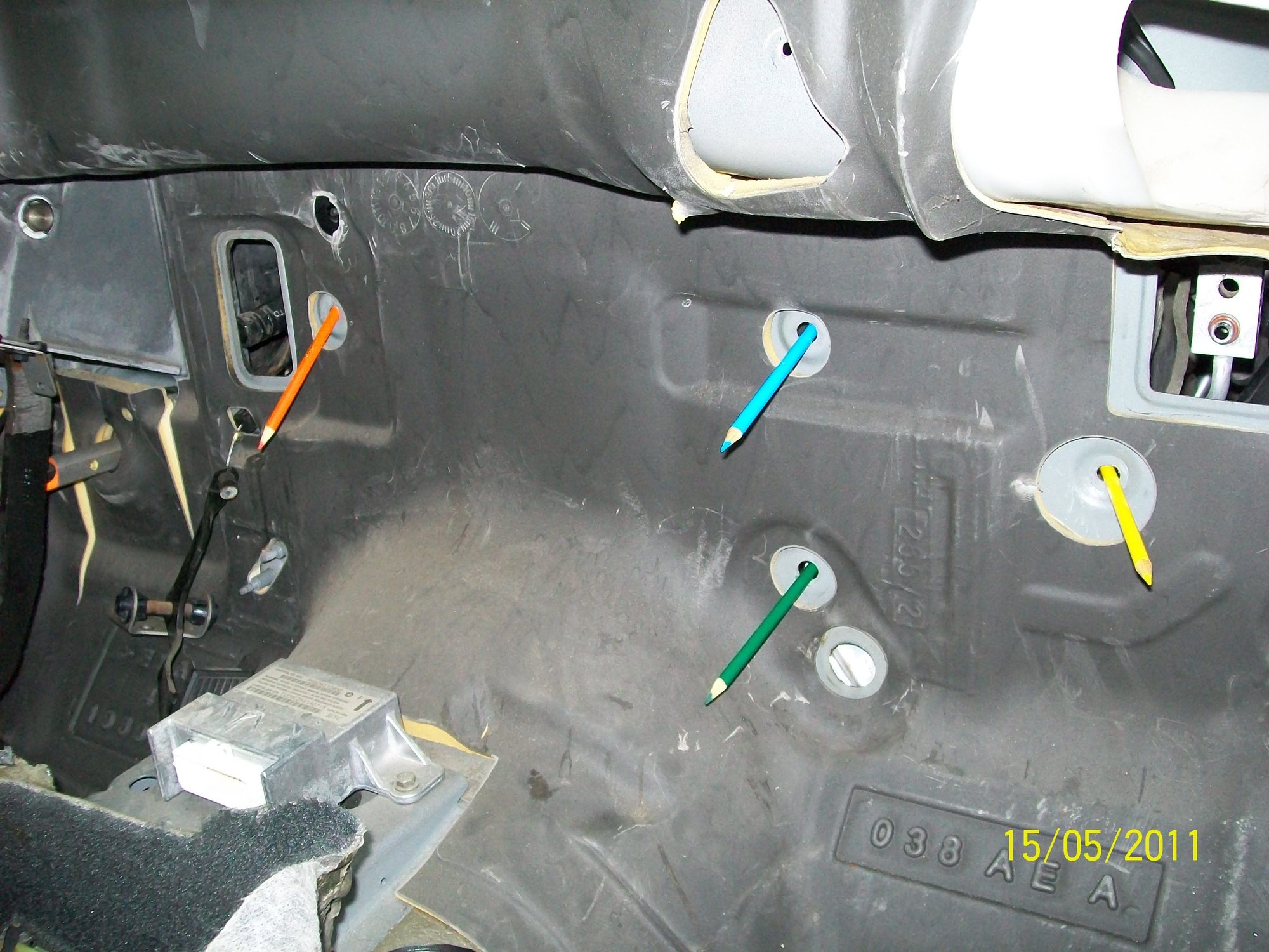

For those of you looking to tackle this project I have a ton of pictures I took back in 2011 when I did this the first time. I had an awful time trying to find one of the bolts you needed to get to. So I stuck some colored pencils in the mounting holes and took pictures in the hopes it might help someone else.
This picture was taken after I got the dash and heater/ac control box out inside the Durango. I will try to post some pics of the engine side of the firewall next.
