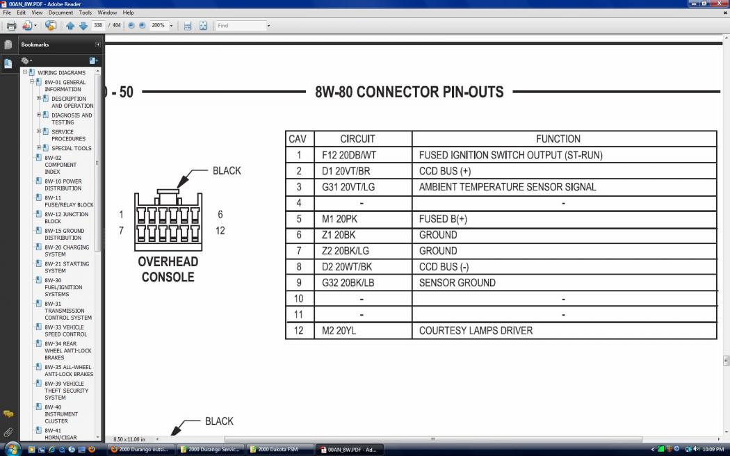

Here ya go:

Thank you kindly sir. That side of the plug, (in the console), I have. What I'm wondering is, about the 2 pins on the plug itself where the sensor plugs in. For instance looking at the pin side of the connector where the sensor will plug in, (not the side where the wires come out), which one will be the (+) and of course the other being (-)....Thank you much,
TV

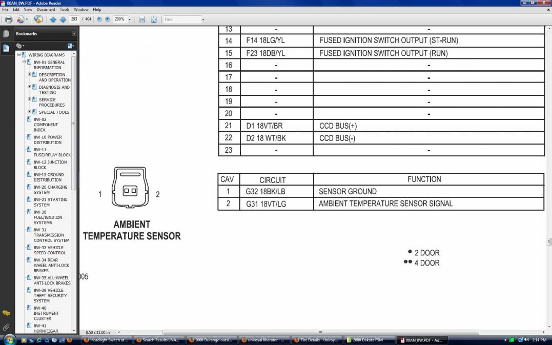

You mean the sensor pin (harness) on the front of the truck next to the passenger side head light?
