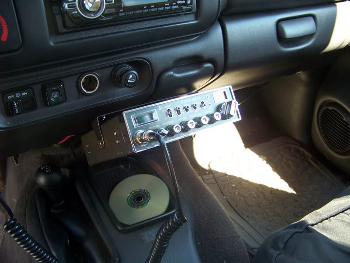

okay well start out with the mounting location for the CB itself. just mount it anywhere i just put mine under the dash where the useless coin holder was.

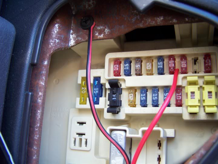

Now for wiring, put the positive into your radio fuse and push the wire and fuse back in its spot so it turns off with the truck, put the ground behind the metal plate and skrew shown.

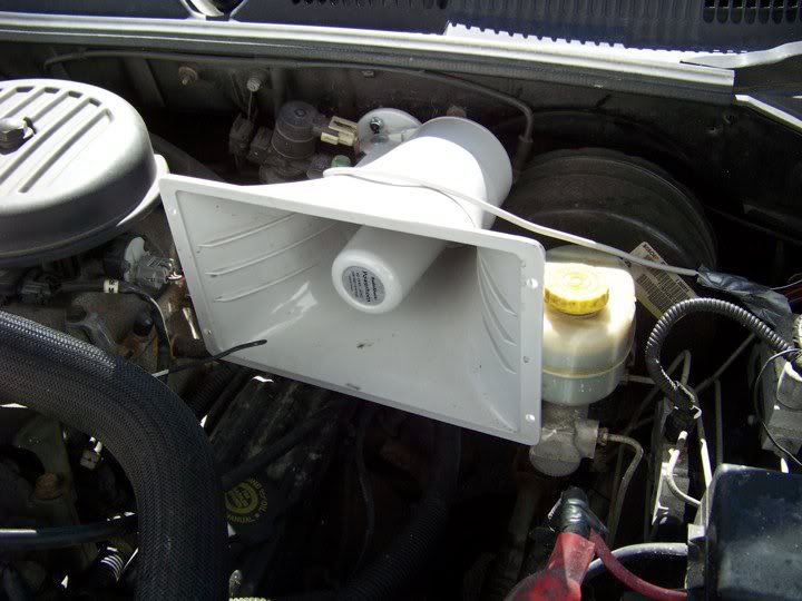

Now for the PA you have to wire a headphone cable to the PA and plug it into the back of the Cb where it says PA and your done just switch it over to pa and you can yell at people all you want
