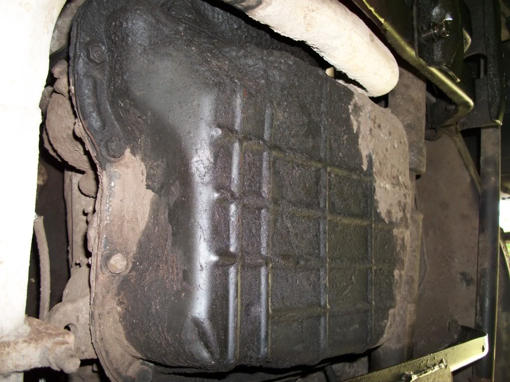

I have some questions.Did you have a 4x4 transfer box on the end of the transmission? And can you post a picture of the transmission oil pan? I can tell what transmission you have by the shape of the oil pan.

Old Jul 24, 2010 | 07:25 PM
backwallkiller's Avatar
backwallkiller
Joined: Jan 2010
Posts: 29
From: ocala florida
Default tranny pan

Old Jul 24, 2010 | 09:42 PM
master tech's Avatar
master tech
Site Moderator & Tech
Posts: 11,642
Likes: 108
From: Near Sacramento,ca
That transmission is a 46RE transmission. Not a 42/44RE transmission.
