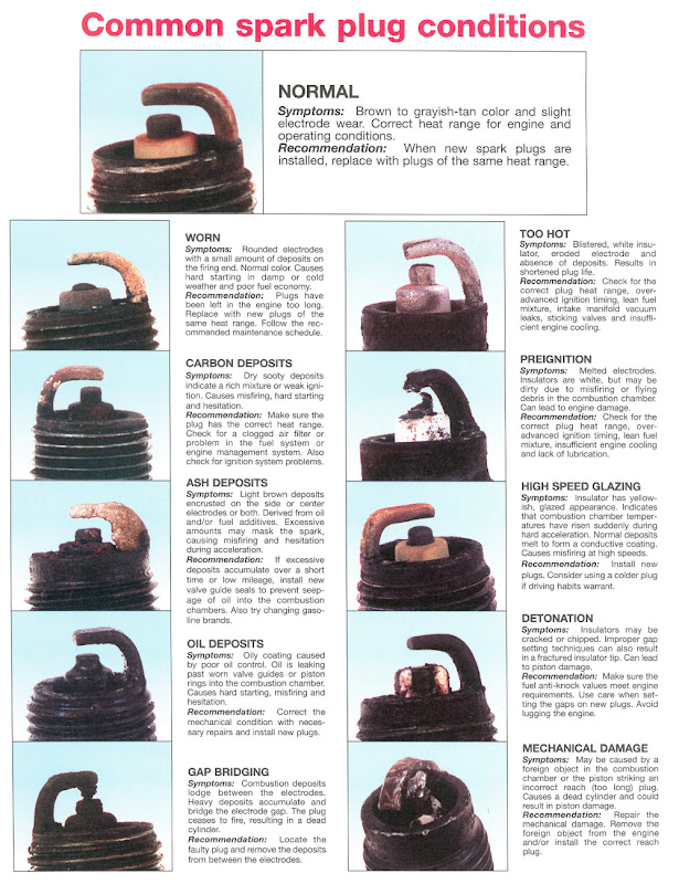

another thing to check is what the plugs look like after a couple hundred miles of driving (1-2 tanks of gas), this could tell you alot, i have a feeling that the stalling the CEL are unrelated

when i changed the platinum plugs, they had 300 miles on them and they looked good.
