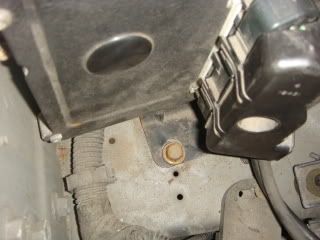

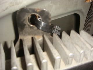

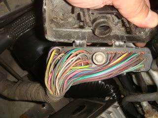

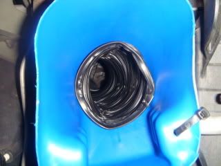

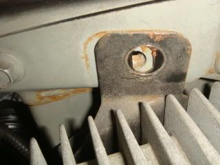

Originally Posted by Dans01Durango
Okay you all know my dismal first attempt at making a homebrew CAI:
https://dodgeforum.com/forum/1st-gen...console-2.html
Here is my second attempt I hope I redeemed myself hydra and Indy.
First I disconnected the TCM wireloom using the bolt to loosen the connection.
Okay, here's the TCM's bolts: It has three one right at the top middle of the TCM bracket and two on the bottom of the bracket.
I had to bend the tab that was protruding out of the bracket cause it was getting in the way of the frame. I also bolted the bracket into the frame using one of the existing bolt holes.
Then I zip-tied the top bracket hole because it didn't line up with the fender wall. Then I tightened the bolt to make the connection.

The homebrew scoop for the ram air.
Before it was a scoop. I cut off the narrow end just enough to screw the tubing in to make a secure connection and I cut off the lip at the opening of the funnel.
The view after I zip-tied the scoop to an a/c line.
The view through the grill.
