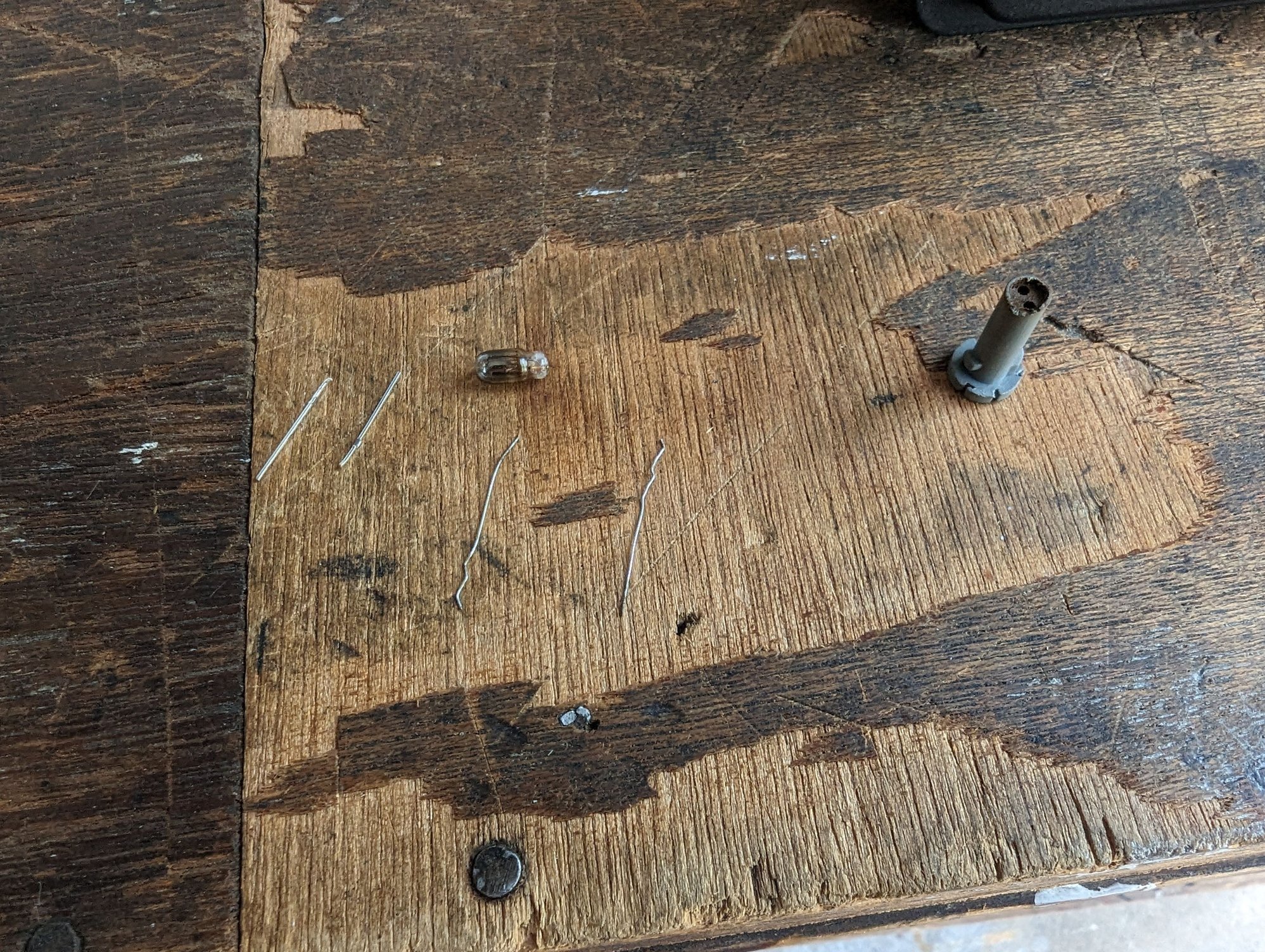

So it seems no one really has an answer but "try to find a replacement bulb" so after I bought led replacements for the climate control... I came up with the idea of remove the old light bulb, grabbing an led on from a Christmas light replacement kit. My thought is if what you buy is an led light in the OEM socket, why can't I just switch out the incandescent for an LED
I had to solder longer connectors on it so I could feed it through the original light bulb housing. Definitely could have made them longer to wrap the connection better but it works.Also had to remove a tiny bit of plastic from the housing (Razor blades width) since the connections I soldered were a little thicker then the original so I needed to be able to turn in a tad more to lock in place. In the end.. I'm happy,. Way cheaper then the model and these bulbs are next to impossible to find. Only thing I may do differently is try to figure out how to get a little brighter but with my lack of knowledge on this, I'd rather it be lit but dim then possibly be asking to much power or watts or whatever and burn the module. P.S. I have no electrical school just good with Christmas lighting repair so I merged the 2.
I used a 5mm led white light. NOTE- I do know led are diodes and diodes work 1 direction so mark the positive and negative on the module and the bulb housing before you build it so you don't build it backwards!
This is the housing with the old light. I was going to solder these 4 legs to make 2 login ones but I sacrificed another new led for new legs which is why I stated before I had to take a razor blade blades with off the plastic housing for the bulb for the connection to mate because of the thickness of the new vrs OEM
These are the 2 I decided to sacrifice solder to the light. I recommend making them longer then I did as you can always cut them
This is what I had
Incase your wondering the power draw... Maybe someone who understands electrical more with leds could mention what could be done to have it be a little brighter as I stated it's not the brightest
I used orange Marker to mark negative / positive. I forget what used orange for exactly, black line was to make sure I kept the negative and positive where they should be
This is this final product. Not perfect but better then just having the tiny fog light lit up and everything else dark
