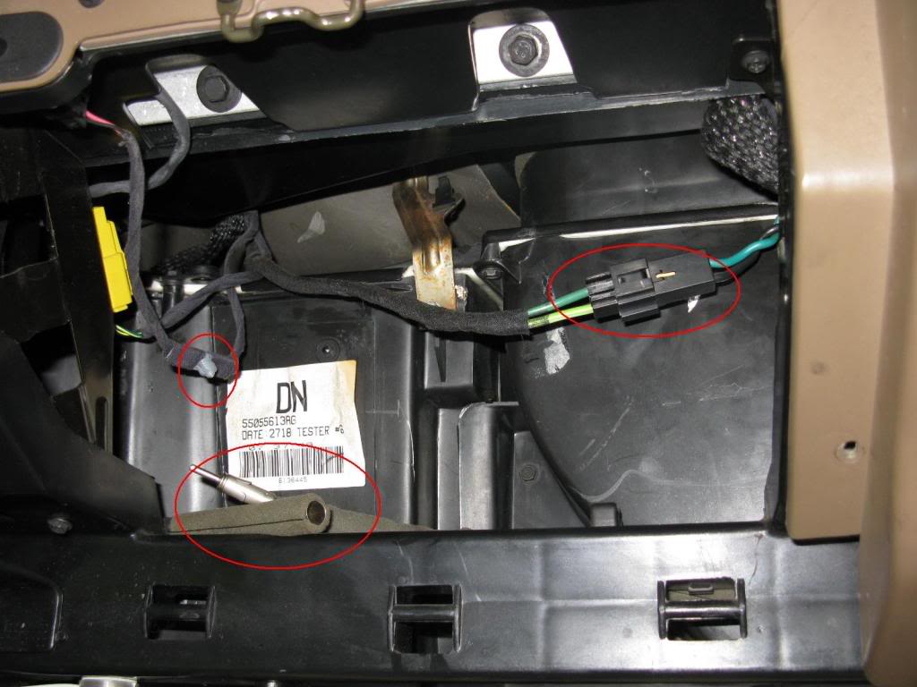

What about that blue plug harness in your picture?

my plugs look the same, thats the only other thing i was wondering about, cause i still dont know where that wire could go, except for maybe there haha. But I did figure it out, its the resistor. its like a 20$ fix, thanks so much guys.
