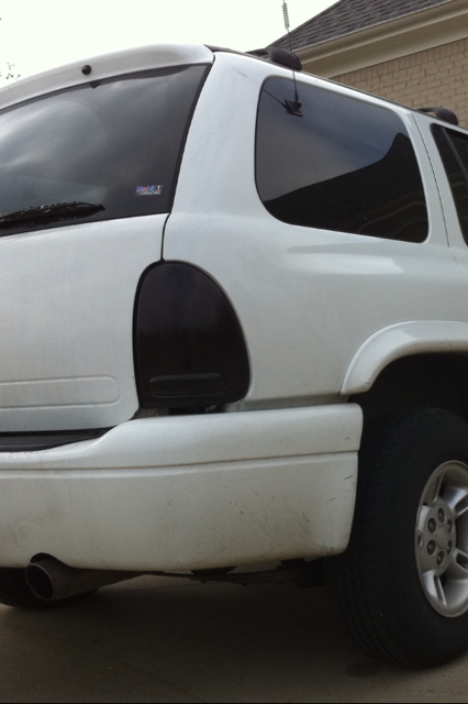

Just have them extend the bracket a bit (or just put a new bracket to look clean) and have the stock pipe about 3/4" lower and tilt the tip down just a HAIR. Not too much, this is what I did as well as take a RotoZip with a rasp bit and take off a little bit of the bumper in order to make it clear with plenty of room.
Check it, below is a picture of mine with a 4" tip and looks very cleanly done...

Looks beautiful haha! That's what I'll have done! I ordered a powdercoasted, 45 degree cut, black exhaust tip and can't wait to hear it with the exhaust! Basically, I'll tell them, do what you gotta do, just make it fit :P Thanks a bunch, nice Durango btw!

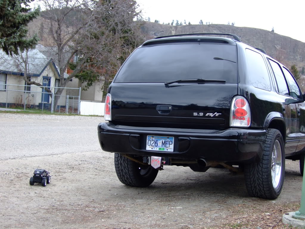

this is my Magnaflow tip ..sorry not a close up . but it sits nicely in the slot.......Name:  01RT007.jpg

I like it haha! Looks very clean and sharp, and btw, nice R/T ! The R/C car makes a nice addition as well :P!
