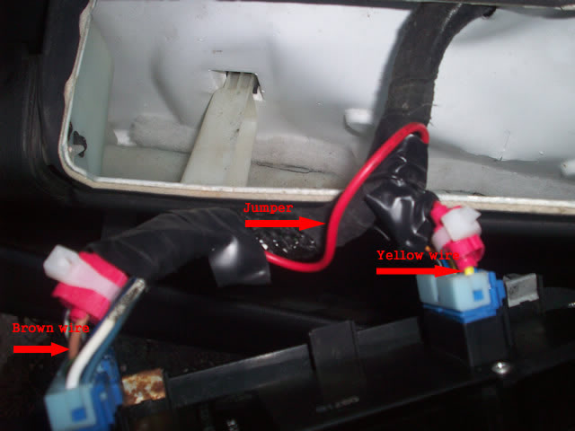

sounds to me like his lockout button might be all thats shot, if thats the case the only thing that needs replacing is the drivers side master switch, and if he is ok w/o the lockout i would just jumper it as shown above

As of today I have decided that my master switch is goofed up. I tested the switches previously and they all worked so maybe it was just a recent break. What gauge wire do i need to use to make the jump?

I just found this thread and although I've had issues with my passenger door window, I don't generally carry a passenger so it was never a pressing problem. Wifey is out of town and I decided to do some digging on a few things and discovered this thread. Today I did exactly as shown using #14 stranded wire. She's going to be happy when she gets home!!
Thanks to the original discoverer of the repair. Gotta love these forums!

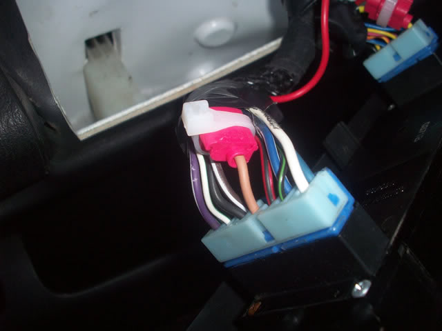

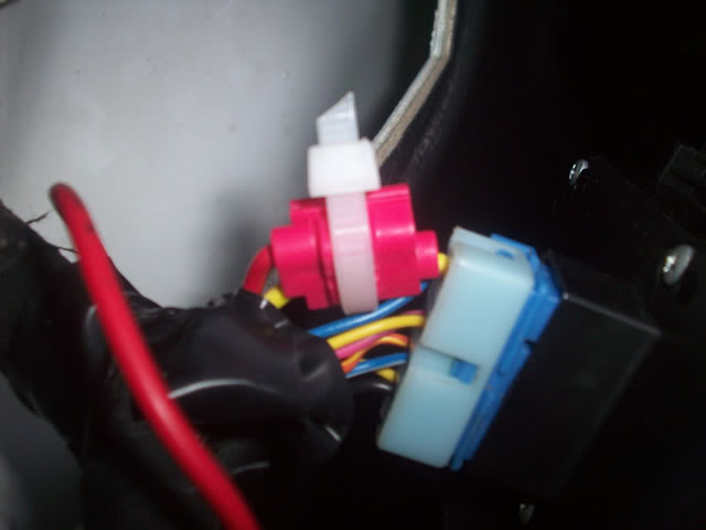

Originally Posted by Mastec
Here are the pictures
Just splice the one end of the jumper into the brown wire and the other end into the yellow wire.
Attachment 69184
Attachment 69185
Attachment 69186
Took a total of 5 minutes to complete
I have an 06 Dakota and I just don't see those colours in the door wiring harness (if that's where they are supposed to be) looked under the dash too, but couldn't find them.
Under the dash/steering wheel
Wiring harness at the door for the lock out and pwr windows
