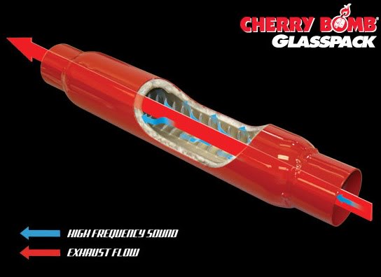

Like Brekar said, if you're not doing a CAT-back and just replacing the muffler you'll need 2.5" in/out and plan on welding some spare pipe because the stock muffler is way bigger than 26". Also, hopefully you know this is the loudest thing you could of picked (being a glasspack) it is in no way a muffler and is more of an amplifier. A glasspack is straight in and out and no muffling at all and the "glasspack" that's around it amplifies tone to make for a louder noise.
If you're wanting a nice noise and not obnoxiously loud, like topdogcustoms said, a Flowmaster 40 will give you a nice combination of loudness and tone. A glasspack also affects the amount of backflow you have substantially, and although I've never heard of issues regarding it, in theory it can do no good to the exhaust system.
How a Glasspack works:

Glass packs are good, but I prefer Magnaflow. Same by design (straight flow design) but quiets it down.
