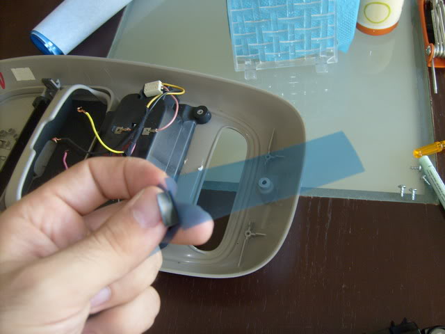

Customize Display Color (optional)
You can change the display color to match your gauges and HVAC controls by doing the following:
Take off the face of the display by removing 3 screws
Get yourself some kinda colored film and place it over the number display
Reassemble your display
