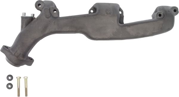

Well here is a picture of the exhaust manifold and as you can see the flange is part of the manifold itself so I'm very confused as to how exactly this happened...
