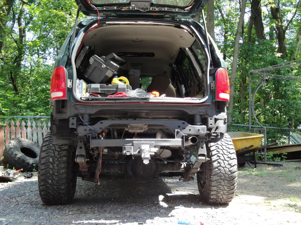

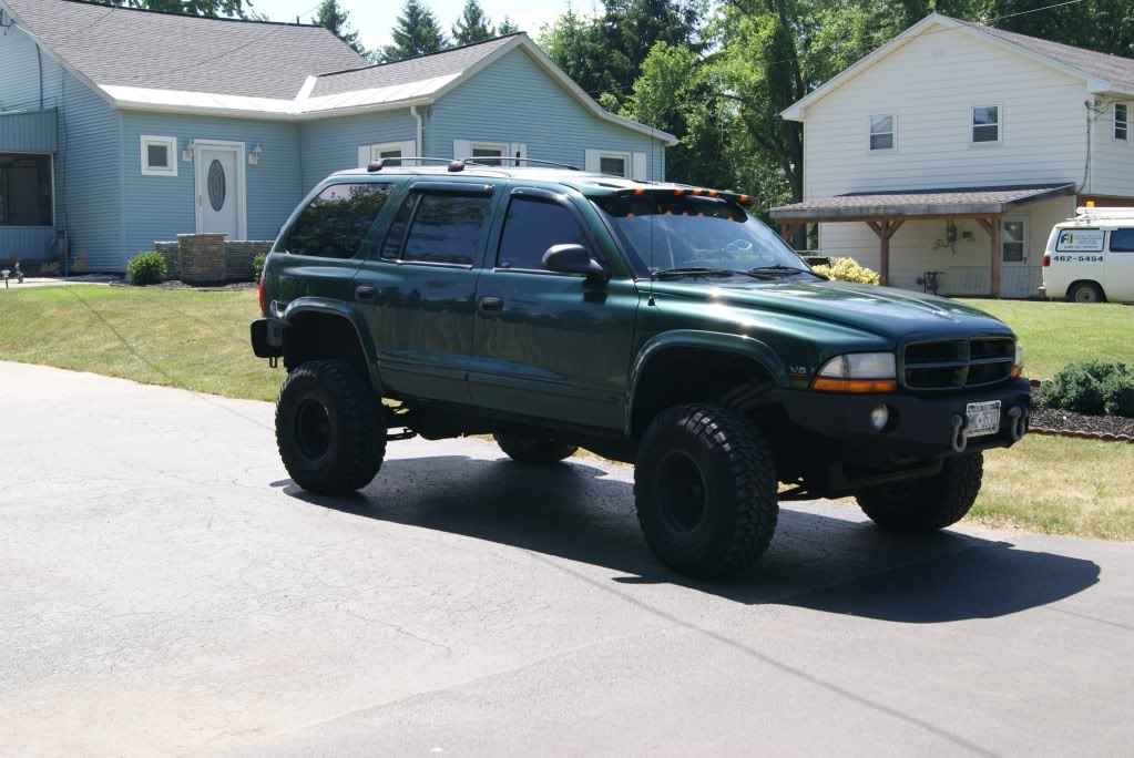

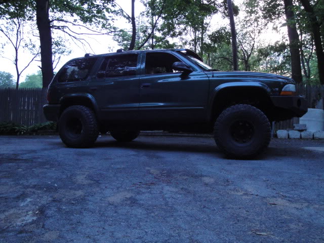

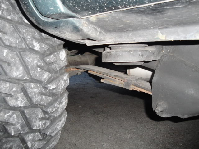

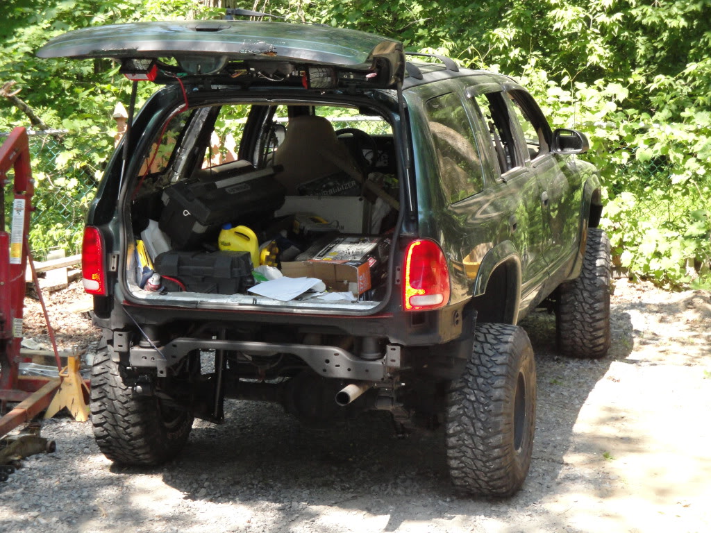

Yeah i only sported a body lift to run larger tires. I never ran AAL's though, maybe because i swapped for some Dakota +4" rears that helped with payloads.
Mainly because i snapped my orig leafs playing dirty

duranged what did you put on? what are the +4" rears your refering to?

Dakota leafs with +4" of lift

where did ya get them? did you have to extend your shocks at all or the stock ones work?

Cant remember exactly where i got them, i'll have to check into past purchases. They were orig purchased for my SAS but at that time i had no other choice but to use them so i put factory shackles back on and kept them axle over. Factory shocks will not work off the bat due to the arch, but its recomended to throw 2-300lbs in the back to break them in. Factory will work after you break them in but limit your travel so i'd look into longer travel if you want the most out of your droop, i think i went with 3-4" longer throw.

And what did you do to the front to match the rear? You have a mean stance man, most well proportioned Durango I've seen. Sick front bumper too.
