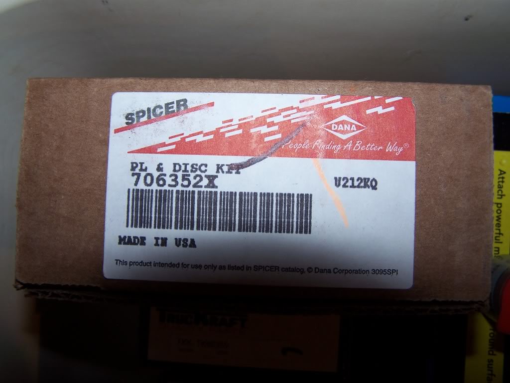

As for your used clutch pack question, used is used, the clips can just pop out with worn clutch packs. Really it was a shotty design in the first place. You can buy a new set if you want and have him put it in while he has it ripped apart. Manufactures name is Dana part number 706352X
