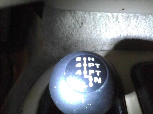

On the floor I have a shifter to go into 2H, 4Wpart time, 4Hi, N, 4Lo. I just got a build sheet and man! Lots of stuff here...but it still didn't say what I was looking for. I know it came with 4wheel abs now but this is what it said for transfer case:
DGTS 4-Spd. Automatic 46RE Transmission
DHAP Lock-Up Torque Converter
DHC Full-Time Transfer Case
Ill go out and get a pick of it now for you guys to know exactly what I am talking about...
Plus I know I have an lsd, and the 3.93 gears now. Which sucks to for me considering I have the 5.9L and never tow. Will these really kill my mpg at 65mph? I drive across the state of WA three or four times a year and need to know if I should start saving now for these trips...lol

I got it! here is the pic...

Wait...is this correct? Or was the D a turn *** for the awd/4x4?
Old Oct 25, 2011 | 12:34 PM
  #37
shrpshtr325's Avatar
shrpshtr325
THE ULTI-MOD
Joined: Jan 2007
Posts: 19,797
Likes: 36
From: Union NJ
depends on the year, 98-00 where a floor shifter 01-03 got an electronic **** in the dashboard.

Got it...got worried for a sec thinking that AWD wasn't an option for 98's. Good to know! Thanks all!

You do NOT have a AWD transfer case. You have a NV242HD transfer case. This is a Part Time case. AWD was not available in the 1998-1999 models. The NV244 is the AWD transfer case and it is electronically controlled. Look in here about half way down under transfer case: https://dodgeforum.com/forum/1st-gen...wers-faqs.html

Holy crap that posting was confusing...so 4pt is not good on any road surface? It says on my visor that 4pt is good on any road surface, wet or dry. And that 4ft is for very slippery conditions only...but the artical here:
https://dodgeforum.com/forum/1st-gen...-hi-awd-2.html
States that 4pt is only for extreme conditions and acts like 4lo...so which is it? What the visor says or what is said here?
