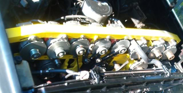

Perhaps maybe this will work better???
Holy Altenator!
Old Apr 28, 2012 | 02:33 PM
Mean Green's Avatar
Mean Green
Joined: Jun 2006
Posts: 4,186
From: Reno, NV
That might be able to keep up.

Holy altenators batman!
