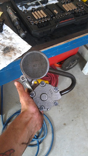

P.S. - I attached a picture of the oil pump filter that i cleaned after i took it off ( Its not new even though it looks like it ) that is attached to the oil pump
