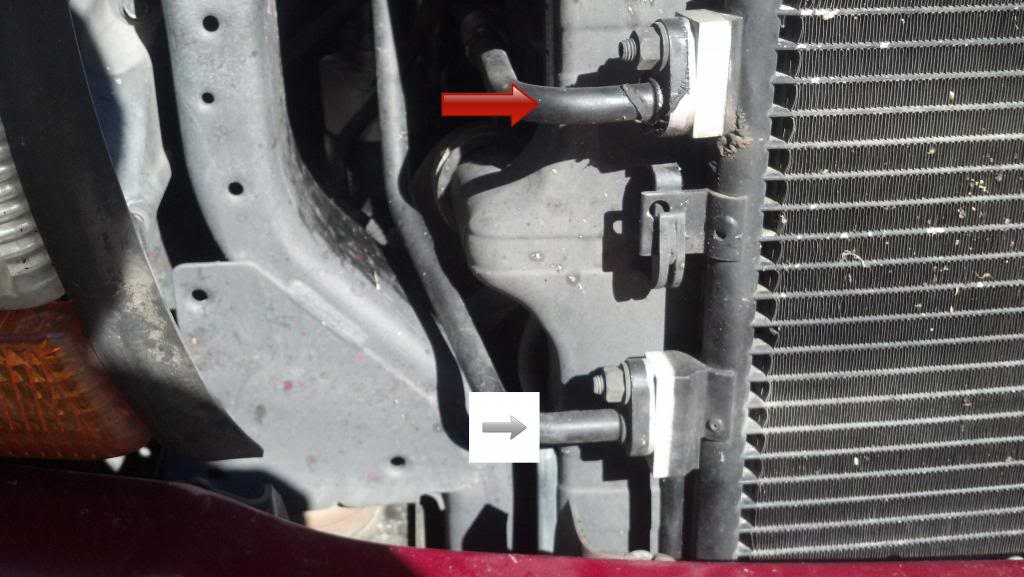

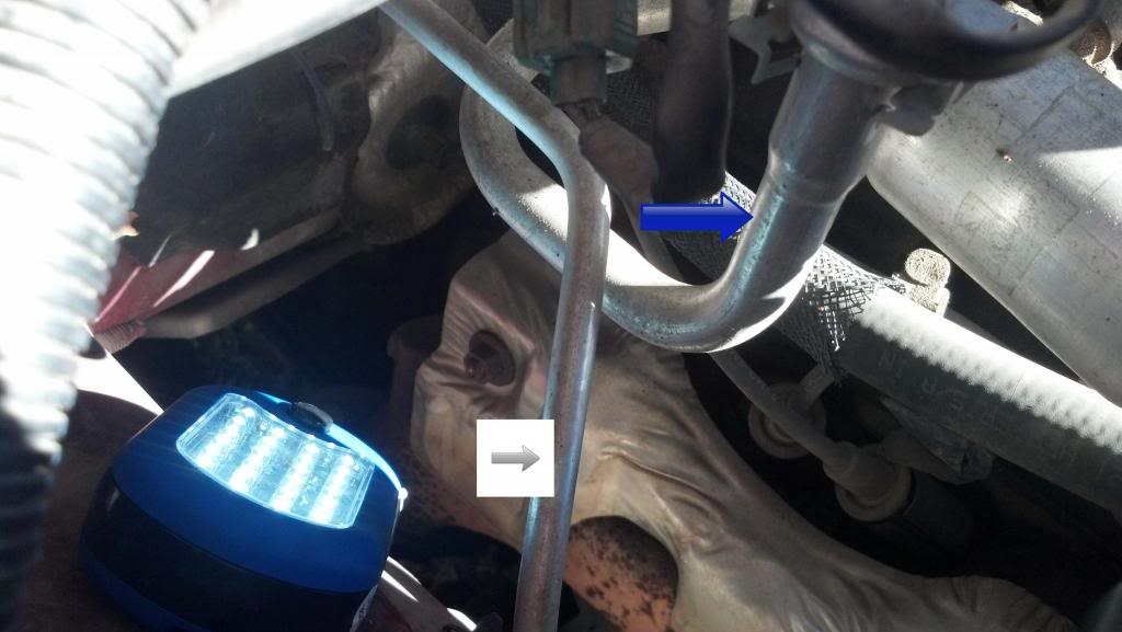

Okay, coming from the firewall, the bigger pipe is cold, almost like its air conditioner cold, and the smaller pipe isn't either hot or cold. In the front under the radiator hose the bigger pipe is still AC cold and the other is slightly warm. In the very front behind the grill of the hood, the top pipe is warm and the bottom is neither warm nor cold.

Thanks Old_School. Cold is blue, warm is red, and neither is gray.
