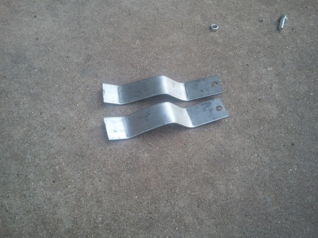

Here are the brackets for the fan

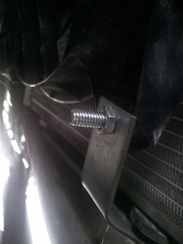

Under the truck.

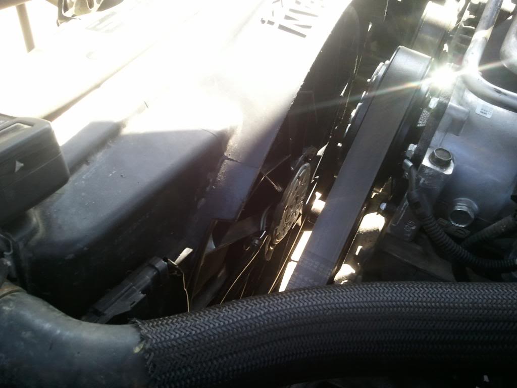

I did notice when running at 60% the fan chatters. Any clue why?

I called flex a lite and let them listen to my fan. They believe the fan is the issue and did not have many suggestions on what could be done about the noise. Yesterday i ordered the jeep fan from summit. http://www.summitracing.com/parts/dcc-cbg4f250 Should be here Saturday.

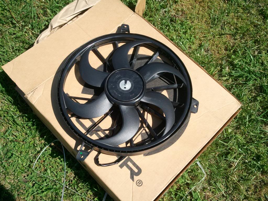

I received my new fan today and have it mounted in the truck. Will be going to the junkyard tomorrow to pickup a clip to connect the electrical.

I finished the install today. I let the truck sit idle for about 45 mins watching the temp, the truck never hit the 210 mark, so i think it will be fine. I have the controller temp setting to the lowest possible settings and it turns the fan on about 10 seconds then powers the fan down for like 2 or 3 minutes then turns the fan back on. The thing really pulls some air.
This is what the termination for the fan looked like, I picked up the female end at the junkyard off a Grand Cherokee
