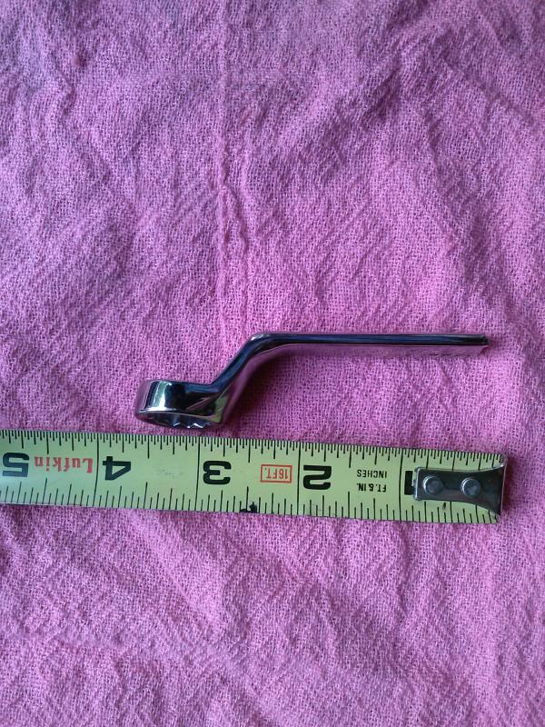

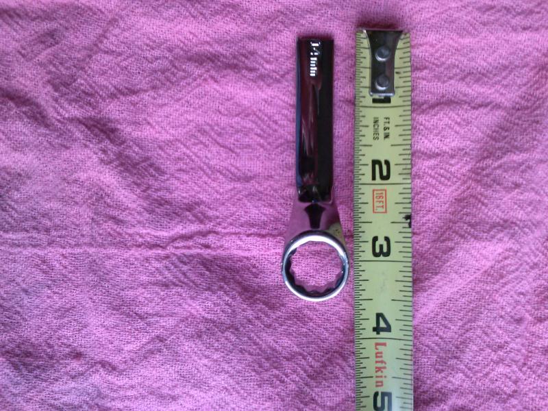

ok, I finally got this POS nut removed. it refused to cooperate with any of the various combination of sockets, swivels and extensions that I tried. and I tried for HOURS. finally bought a 12mm / 14mm offset wrench and hacksawed off the 14mm end to just under 3.5" in length. that got 'er done in no time flat with no problem. there is simply no room to maneuver at that nut's location!
