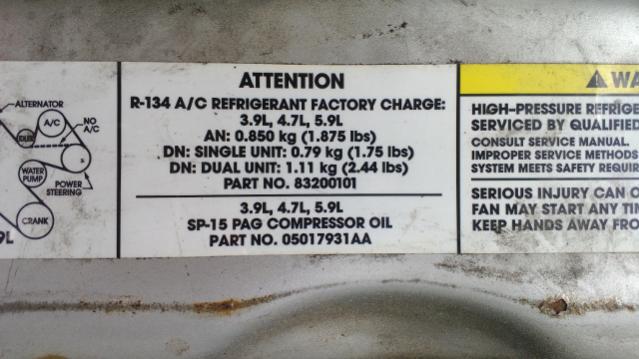

Got busy and just now getting back to this, you had me worried I over filled my system but you must be quoting from a different system, mine takes 2.44 lbs.
I added the 1 oz because I lost some due to a bad gasket at my drier.

Yeah the 98-00 Dual systems only take 30oz (1.88 LBS)
